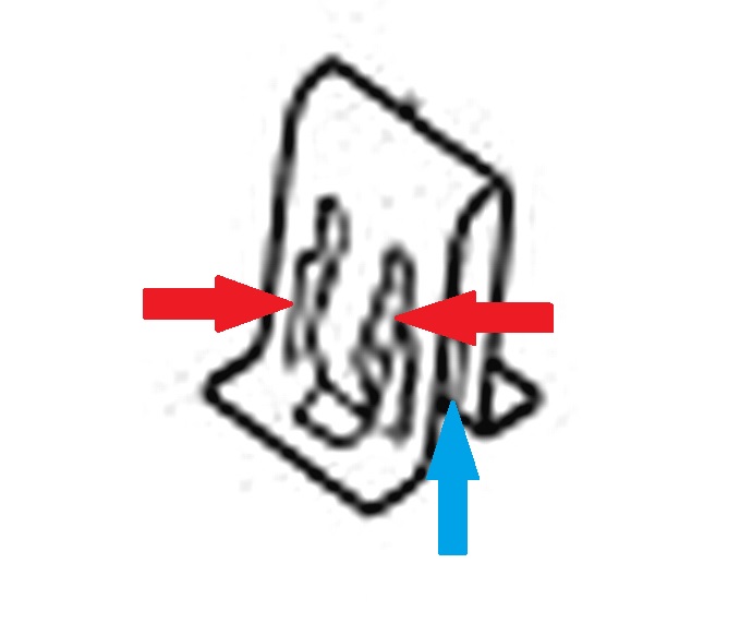

The Roof Console is secured by three spring clips:
Gently and gradually pull it straight down from the edges to release it.
Watch out for the spring clips. They have 'teeth' and draw blood very easily! The plastic 'tongues' on the Console are also easy to break.
Quite often one or more of the spring clips remain attached to the Console as it is removed.

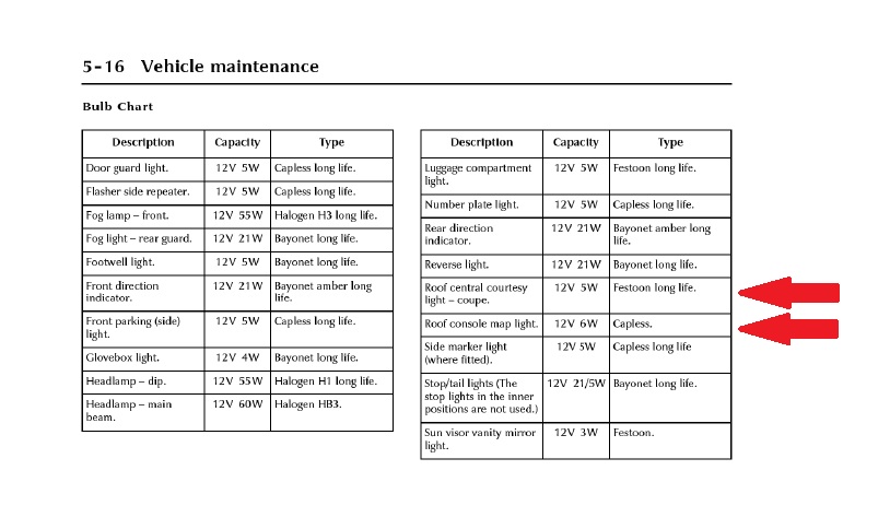

.... I need to take it all off to replace the bulbs. Also I cant find what type the bulbs are in the center top piece.
The Bulb Chart is in the Vehicle Care Handbook:
If you don't have the Handbooks, all the XK8/XKR ones are available for download from here:
https://www.jaguarforums.com/forum/x...006-faq-67827/
