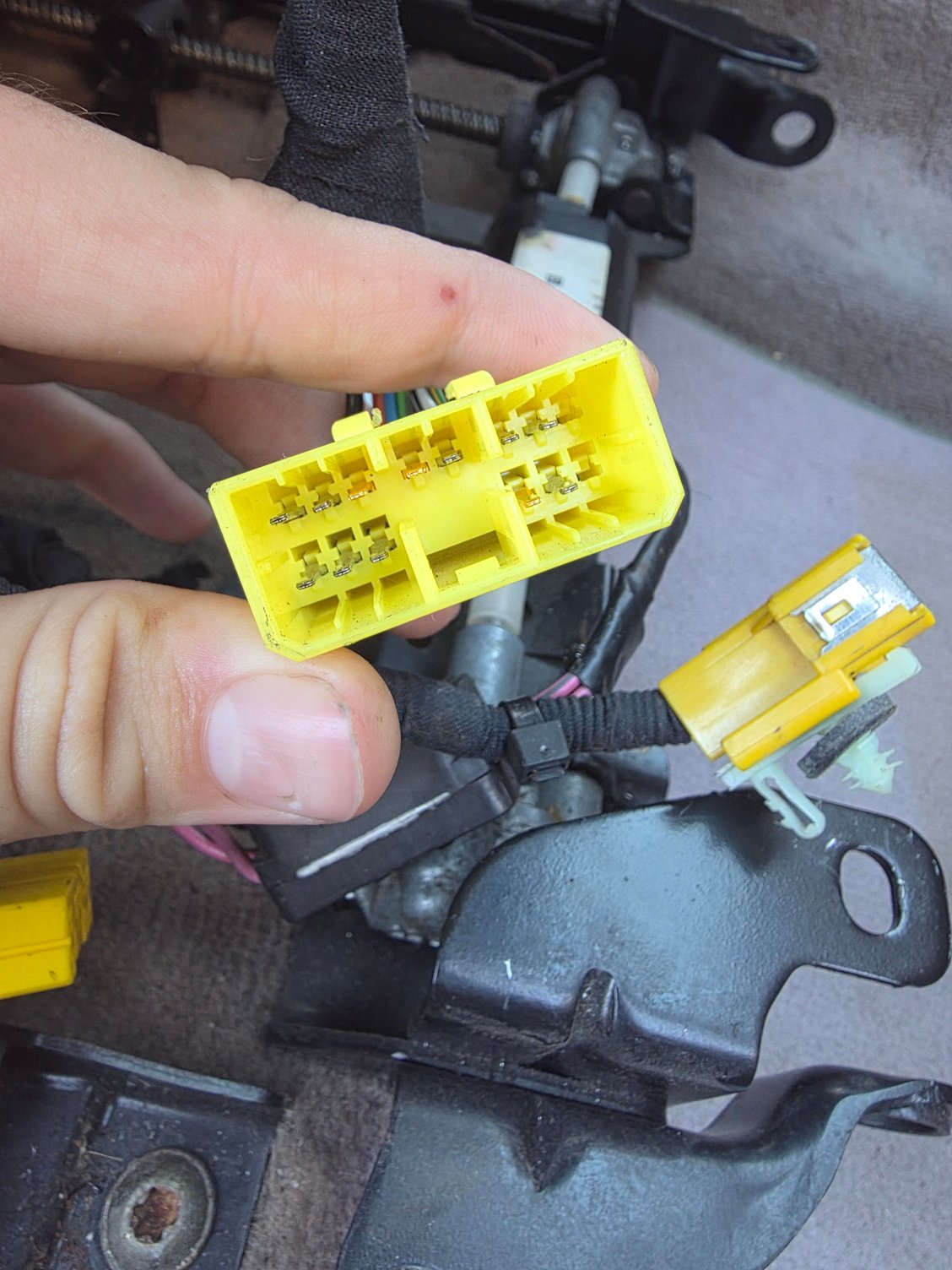

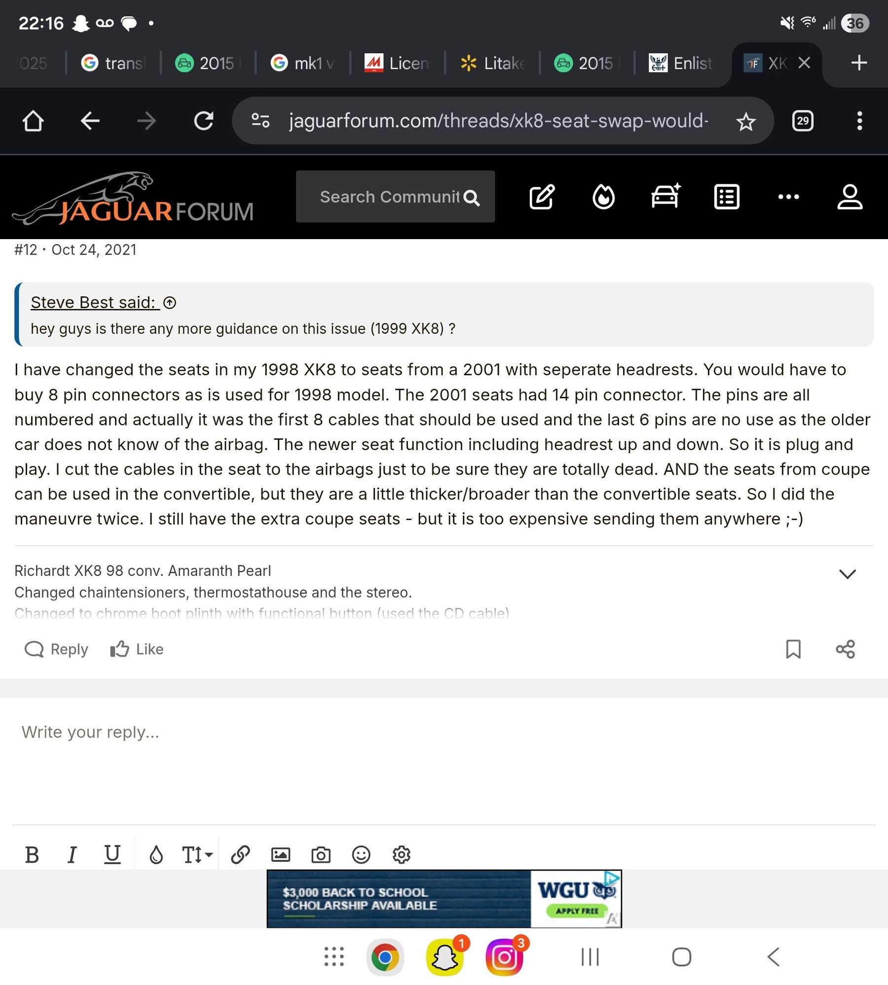

Hi guys, so the interior of my xk8 has seen better days so I found an 2001 xk8 in a junkyard near me with seats in much better condition from mine. As im sure all of you know the wiring was changed from the 2 different seats. But I found an old forum that said that with certain connectors they can be plug and play. I have zero wiring skills so could you guys point me in the right direction? What connector would I need? Thank you
