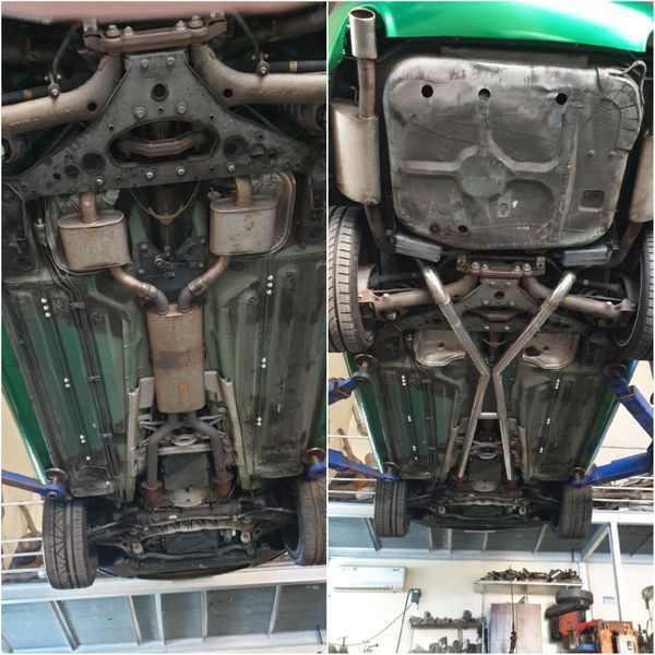

I used you as my inspiration however I did 2 things different
1. 2.5" pipes
2. Went under axle instead of over axle
Strange thing, Im not getting pops and bangs, something I did wrong?
1. 2.5" pipes
That looks like a much cleaner setup than my mishmash of stock and aftermarket piping. My pops and bangs aren't the near-gunfire ones you'd get from modern performance cars, just muffled burbling after lifting off the throttle, so perhaps yours is just subtle. Exhaust sound tuning is a mysterious art anyway, so your unique piping and H-pipe setup might be set up perfectly to discourage pops and bangs.
