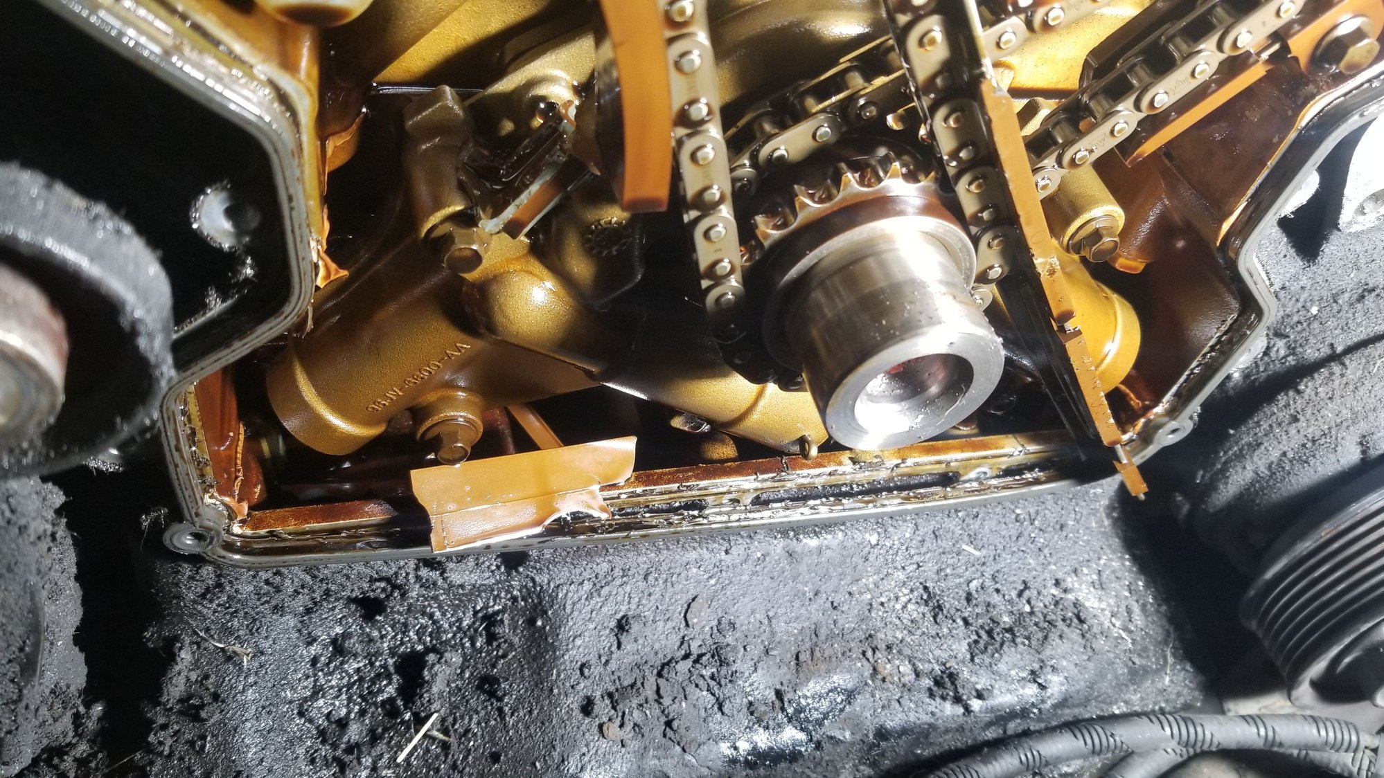

I recently replaced the tensioners on my wife's xj8. There was a noise coming from the front of the engine. I thought it was the water pump so I took off the serpentine belt and the noise was still there with the engine running. Took the cam covers off and one of the guides didn't look right. Took the timing cover off and the photos show what I found.
One of the guides was completely gone. There was no engine damage and it ran fine.
If you only do secondaries take a light and check the giudes for cracks. I have had 4 or 5 of these apart and on every one the guides were cracked.

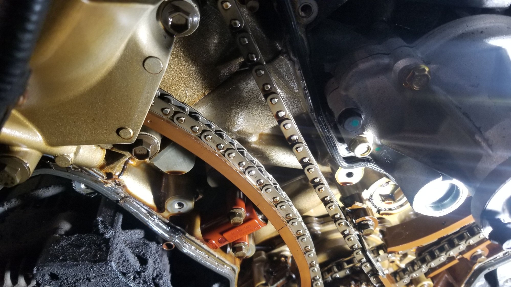

I bought this car from a guy that waited a little too long.
He started it one morning and started running rough. I assume it just jumped one tooth. He took it to an unnamed shop to have it diagnosed. They ran the engine trying to diagnose the problem, this shop didn't specialize in Jaguars. The engine eventually froze on them.
I bought it for $800. Before the shop worked on it it was probably worth 6 to 8,000.
This is what I found when I took the cam covers off.
And what I found when I took the head off
This was 4 or 5 years ago. The car is back on the road now.
Moral of the story is definitely change the secondaries, unless you have a coule of spare engines like I do. If you only do secondaries look down at the guides to check their condition. If you can afford it and plan on keeping the car change the guides and primary tensioners too.
