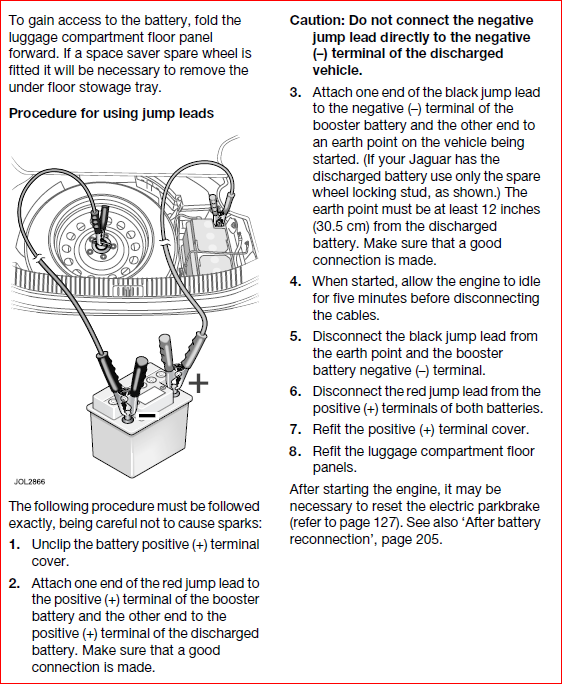

I'm not an expert, but the manual does in fact tell you to use the centre of the spare wheel as ground and the battery terminal positive for positive, along with a whole host of warnings of what not to do, including this one:-
Do not run the jump start vehicle’s engine when boost
starting a Jaguar Vehicle. If the jump start vehicle’s
engine is running and the jump leads are
disconnected, damage to the Jaguar vehicle’s electrical
system will result.
This is from the S-Type vehicle care manual, but it is the same as the XK8/R:-
Sometimes it actually pays to RTFM.

I see you know better than Jaguar who gave very specific instructions on how to jump start the 4.0 XK8/R to avoid damage to the electrical system. From the Vehicle Care Handbook that came with the car:-
Do not run the jump start vehicle’s engine when boost starting a Jaguar Vehicle. If the jump start vehicle’s engine is running and the jump leads are disconnected, damage to the Jaguar vehicle’s electrical system will result.
