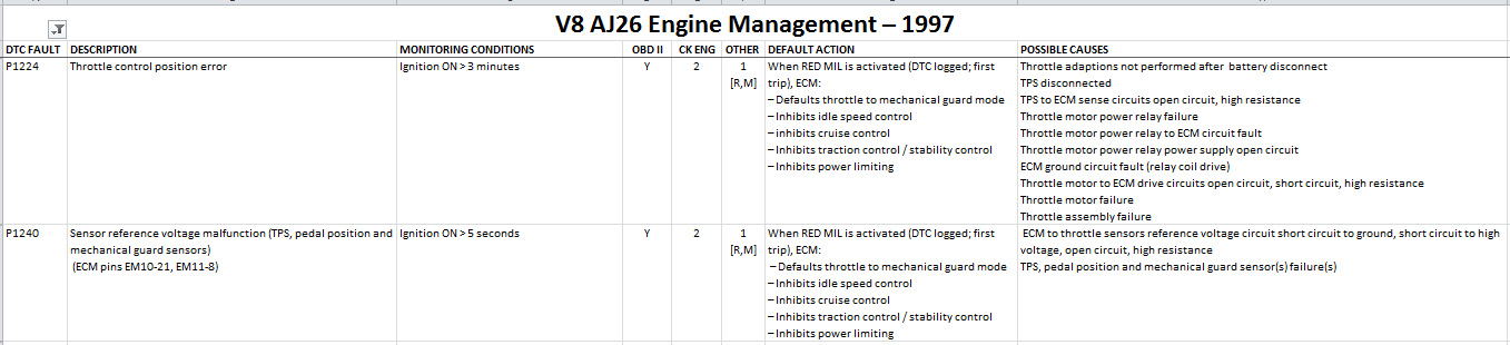

I forgot to include the OBDII codes are P1224, P1240.
The TPS on our early cars (AJ26 engine) is a solid-state Hall-effect device which, in theory, is unlikely to fail. It's worth checking the possible causes associated with those two codes as a starting point:
Unfortunately, Jaguar chose to use ordinary rotary potentiometers for the other two position sensors which will wear out over time. As far as I know, none of these are available separately (at least, not to we unwashed masses) so your choice is limited to either a replacement TB or finding somewhere that can repair your existing one.
