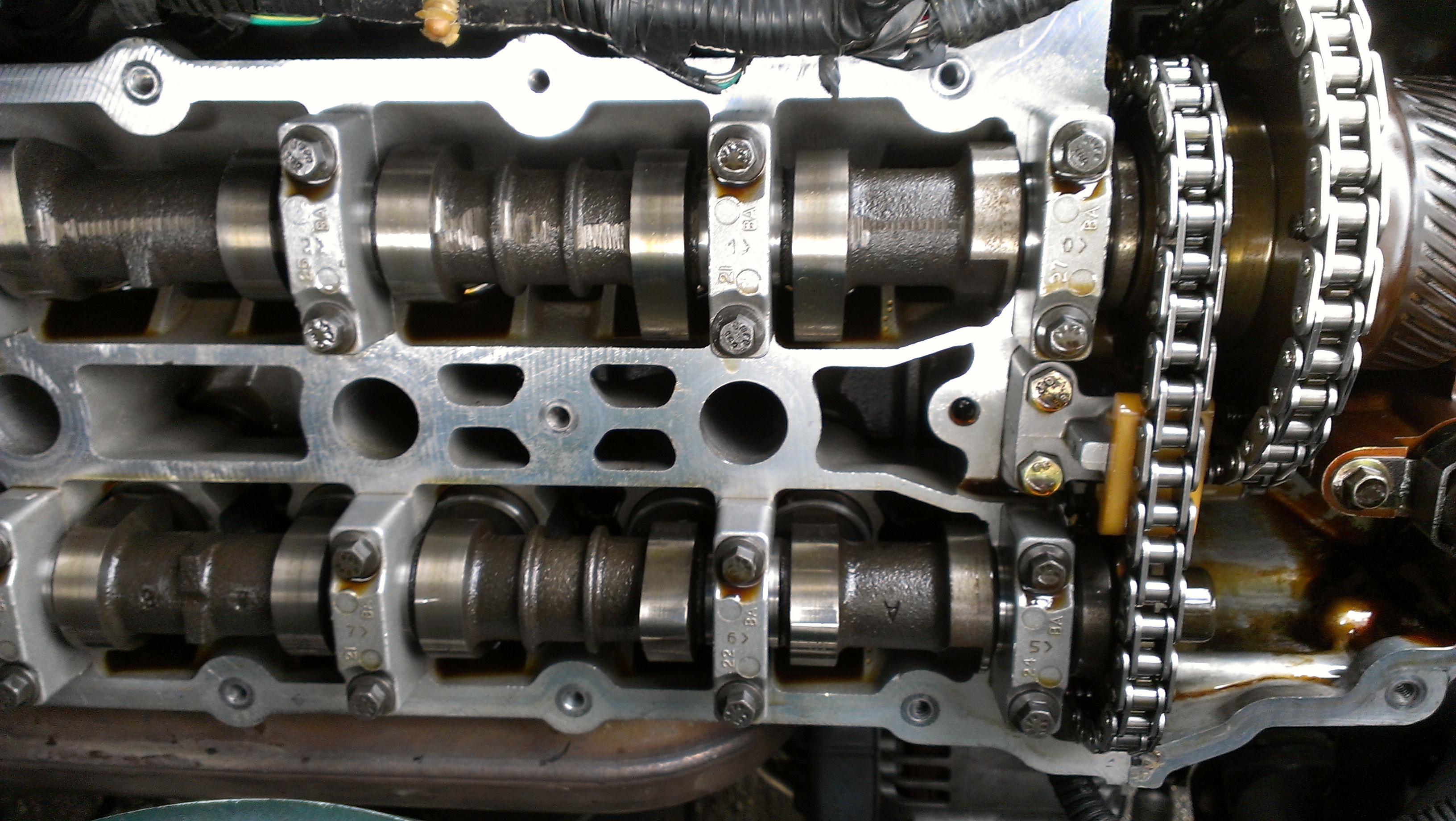

The secondary tensioners should appear as the one below.
Use a bore scope, or similar tool, to inspect the primary timing chain guide rails as they can crack and end up in the sump.
Attached Thumbnails Timing chain tensioners with engine replacement-imag0525.jpg

And we have our answer!

Yes, metal bodied secondaries.
I'm curious about the Morse primary chains - didn't think they arrived until the 4.2?

I see what you mean! Any guesses?

The August 13, 2001; engine S/N 0108130000 4.0 liter onward were supposed to have the metal body tensioners.
This includes the updated oil pump and silent running chains.
bob

But what about the guide rails? Were they improved, or should we expect to replace them on the 4.2L at some time?

The Chain Guide design is different when the silent running sprockets and chains are used as well as the newer style oil pump.
When I replace the timing components on engines UP TO ENGINE 0108122359, I use the original guides part numbers with the metal body (later) tensioners.
The later (narrow) chain guides are aluminum coated with a plastic and look very different from the wider (older) guides. I don't know if they deteriorate like the older ones.
