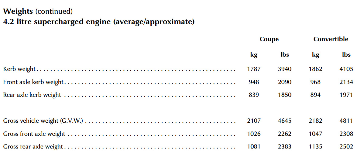

Here are copies taken from the Jaguar XK8/XKR user manual, of the tyre and weight specifications:
Attached Thumbnails Tire Load Rating for XK8-tyre_spec.jpg   Tire Load Rating for XK8-weights.jpg

Great piece of data Stumpy and JSC. Thanks.
