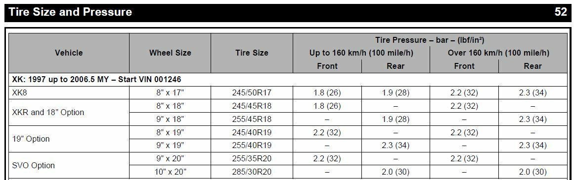

The plate on the console says that I should have 245/50/ZR17 tires with 26# in the front and 28# rear. I have 225/55/R17 and the local shop insists they should be 32# front and 34# rear. Which is correct?

Follow the manufactures (Jaguar) recommendation. It will soon be very clear by the tire wear if not correct.
my manual shows two sets of recommendations, one set for normal (all speeds & over 100 mph) driving and one for “comfort” (under 100 mph) .
I followed the Jag “normal” recommendation on my 18” tires (same of the 17” wheel spec) until the tires showed increased wear in the center of tread vs the edges. A dead giveaway for overinflation . Lowering the tire pressure slightly closer (mid-point to the under 100 mph recommendation) gave me even wear.
I’ve used the mid-point between the 2 sets of Jaguar’s recommendations for several different brands of tires with the same good results.

Wrong tyres anyway ..narrower tyres more pressure. Increase pressures in proportion to the tyre width 245 divided by 225 approx 10%
Front (comfort) 28.5 psi
Rear ( comfort) 31 psi
What your garage suggests is fine as its lower than the high speed pressures with 10% added

The first year of tire pressure experimenting (2012) with my wife's 2006 XK8 proved the optimum treadwear pressures to be 32 psi front and 29 psi rear. Her car has 19-inch wheels with 245/40/19 front tires and 255/40/19 rear tires....

for what it’s worth, For the 17” / 18” / and 19” tires, Jaguar does NOT suggest a higher front wheel pressure.
For the X-100: Fully fueled with no passengers or cargo F/R weight distribution is about 51/49 for a convertible and 52/48 for a coupe.
not significantly front heavy compared to most vehicles.
My successful “
Midpoint” tire pressure is :
Front 29 psi Rear 31 psi
check cold of course.
Z
