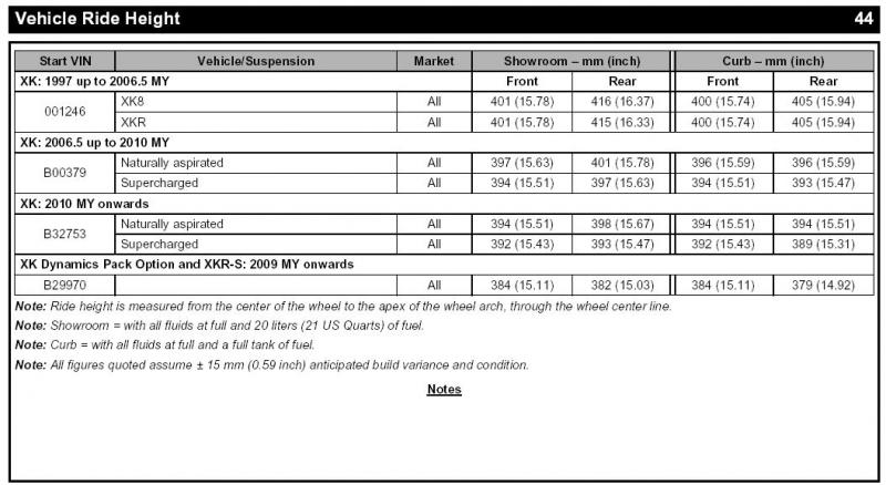

At 14 years old, the front springs could be sagging enough. When I replaced the springs on my 97 all tire rubbing stopped. I had previously put new shocks and upper mounts on it. Still rubbed the tires on bumps. See my Nose Lift thread for the results. Measure your ride height (see chart attached).

Thanks all, I am leaning toward the springs as now I check again there is no bounce which could be they are setting down or collapsed. May as well do the shocks while I'm in there, if they look original. Will look into the top mounts as well.
