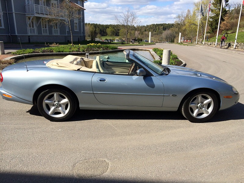

Hi, I just bought me a XK8 1997 Convertible, and it scraches the speedbumps if I approach them a bit too fast.
I am not that familiar to these cars, but have measured the distance from center of the wheel in front to the top of the front wheel arch - approx 35 cm (13 3/4 inch). Is this normal height or is it too low?
Thank you for all your help so far.

Front should be 15.74", rear 15.94". You definitely have a problem. New upper shock mounts can give you 1/2 to 1".

According to previous owner, the upper shock mount (at least on left side) are changed.
Milage is 41000 mile (USA export). I suspect springs to be tired, but the car seems very firm.

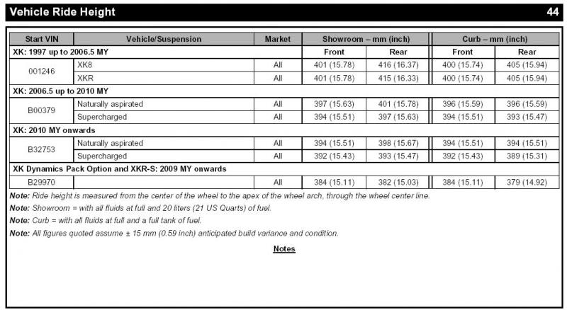

Hi.
Here are all the numbers.
