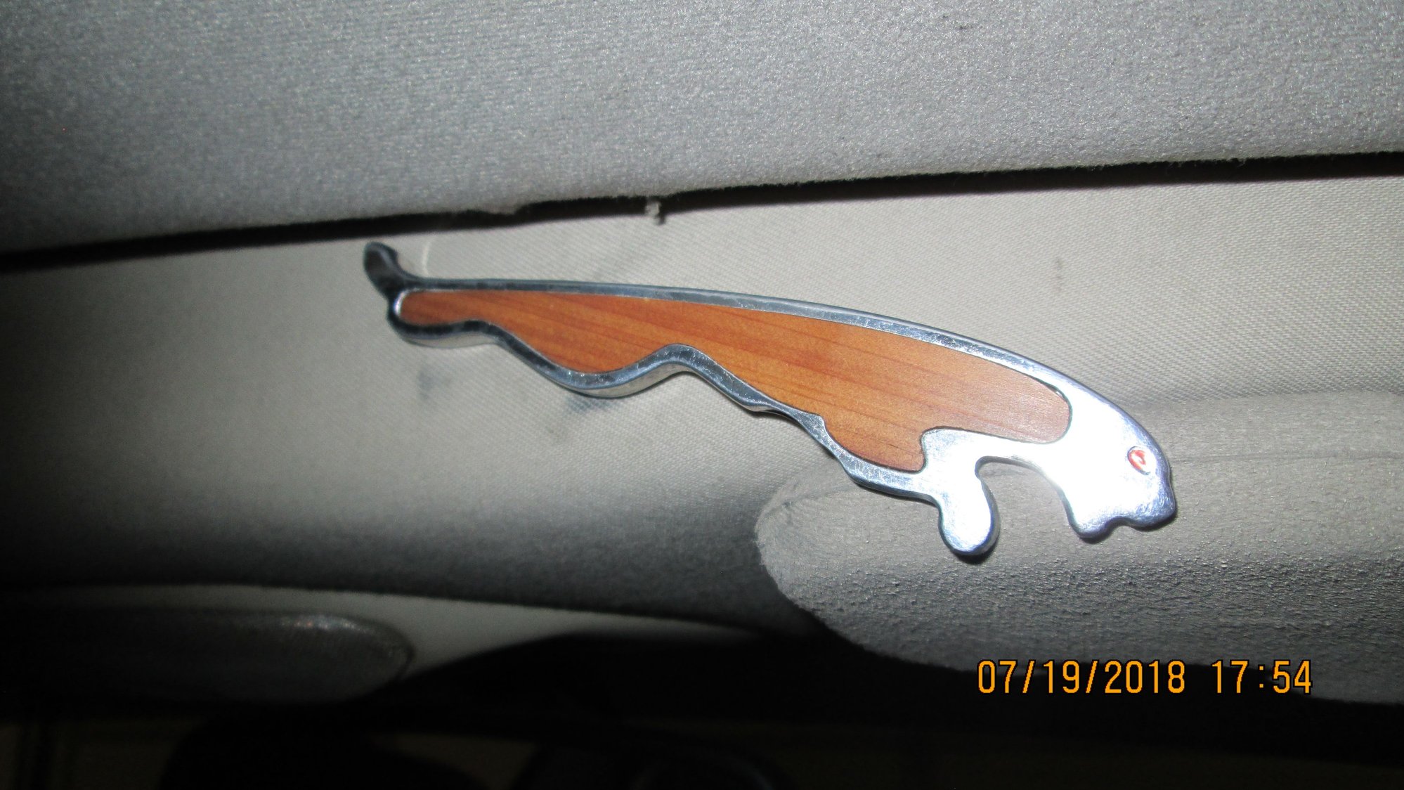

Yes, I am using the allen key. I actually made a little Jaguar emblem as a handle for the key so it looks like it belongs there. That does nothing toward my problem though.

There's a pretty thing now!
