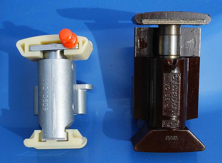

I have pics of the tensioners as I have seen a million posts about replacing them. I just dont know if it was already done. Is there a way to tell now that I can see them?

Your Tensioners are the old Plastic Type. Replace them immediately to prevent Engine Failure.

Paul - thanks... I read the thread about your suggestion but I just couldn't believe it. i did a real short start and move the car, and the way it cranks is like an engine with the spark plugs out. 2 questions ... 1. how much oil and do I have to do each one or can I cheat. 2. The tensioner sure looks plastic, I suppose the replacements are obviously shiny metal?

New Metal Bodied Tensioner and old Plastic Bodied unit:
