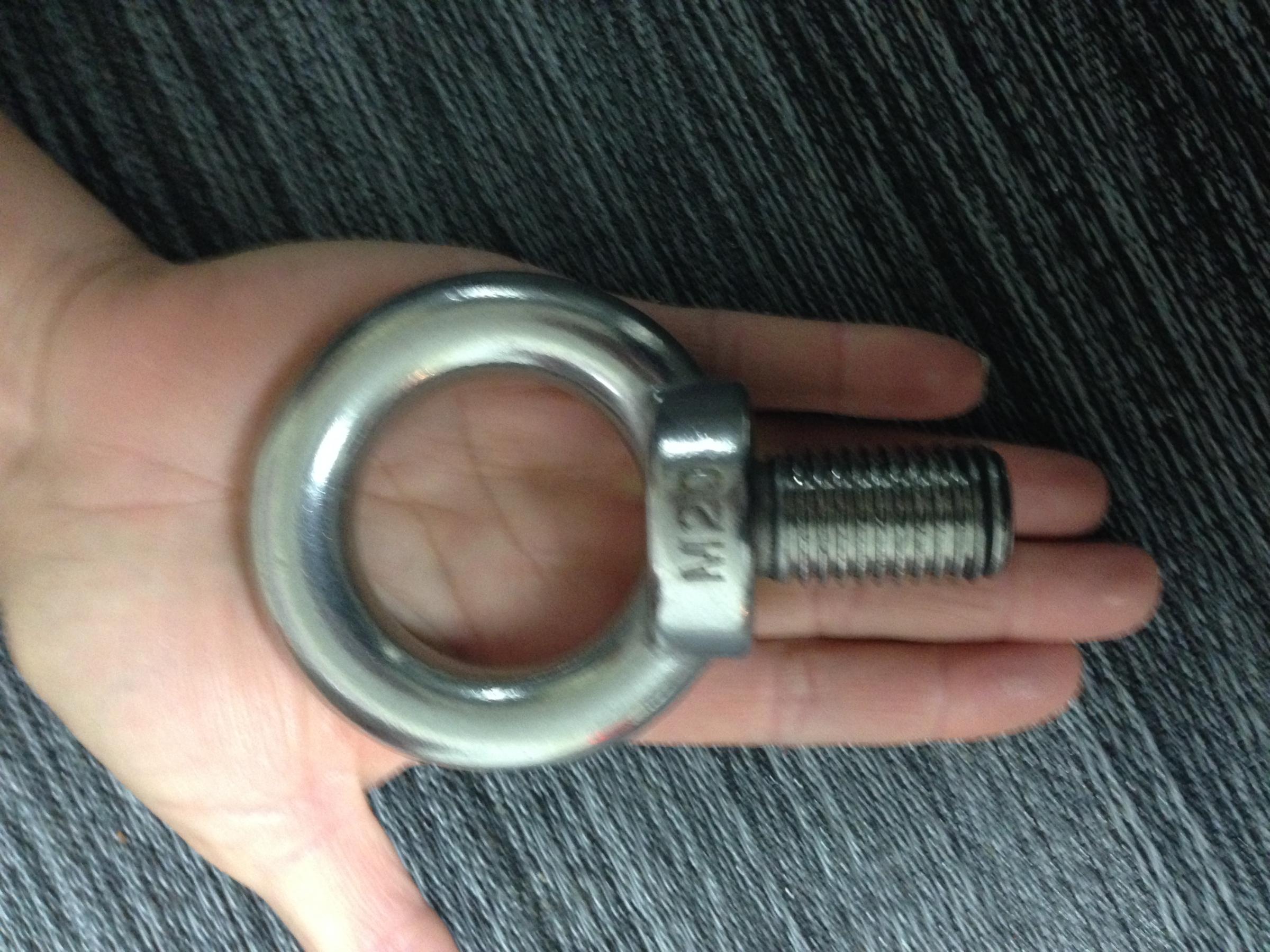

Old Dec 10, 2013 | 09:21 PM
awbj47's Avatar
Joined: Aug 2013
Posts: 15
Likes: 23
From: rockville MD
Default Tow hook replacement 2003 XKR
Ebay
1 pc Eyes Bolts M20 Metri Threaded Marine Grade Boat Stainless Steel Lifting
Price US $17.90 - Free Shipping.
This works perfectly and afordable

Thanks! But does this fit the 2003 XK8?
Old Dec 11, 2013 | 10:59 AM
Posts: 121,143
Likes: 6,654
No, see post #6 above.
Old Dec 11, 2013 | 09:39 PM
awbj47's Avatar
Joined: Aug 2013
Posts: 15
Likes: 23
From: rockville MD
Check the width if 20m it fits.if yours is 16m it will not.
COPY THAN PASTE IN EBAY.
