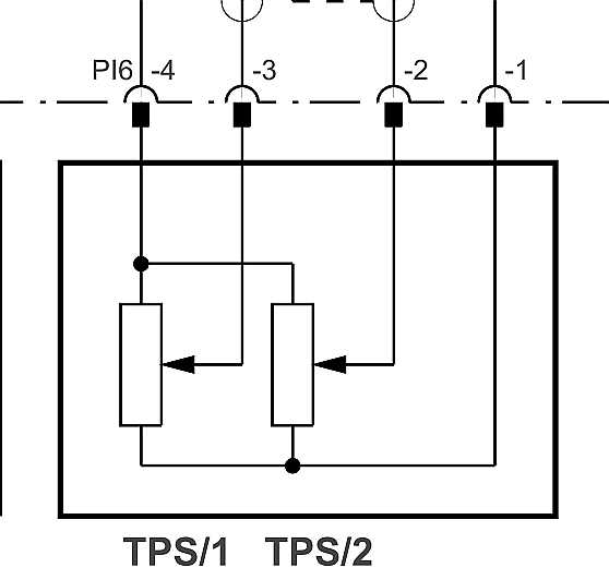

For anyone trying to source a non-jaguar TPS the resistance readings are as follows
(looking at the pins sticking out of the TPS)
4 3 2 1
Pins 1-4 2.24 K
Pins 1-2 closed 1.03 K WOT 2.4 K - this is pad 2 in post #8
Pins 1-3 closed 120 ohm, WOT 2.4K

Just taken some measurements of the Denso 198500-3300 TPS, as used on the X400 2.5 & 3.0, X202 2.5, 3.0, 4.2 & S/C, and the the X350 3.0, 3.5, 4.2 & S/C
Pins 1-4 = 2.272KΩ
Pins 1-2 Closed = 1.448KΩ
Pins 1-2 WOT = 2.376KΩ
Pins 1-3 Closed = 0.736KΩ
Pins 1-3 WOT = 2.169KΩ
Compared to Steve's measurements on the Denso 198500-3250;
Pins 1-4 = 2.24KΩ (very close)
Pins 1-2 Closed = 1.03KΩ (close but a bit out)
Pins 1-2 WOT = 2.4KΩ (very close)
Pins 1-3 Closed = 0.12KΩ (quite a way off, but also offset as 1-2)
Pins 1-3 WOT = 2.4KΩ (reasonable close)

The important thing to look for is the offset on one of the pots. If the two track together the ECM will throw a wobbler.
