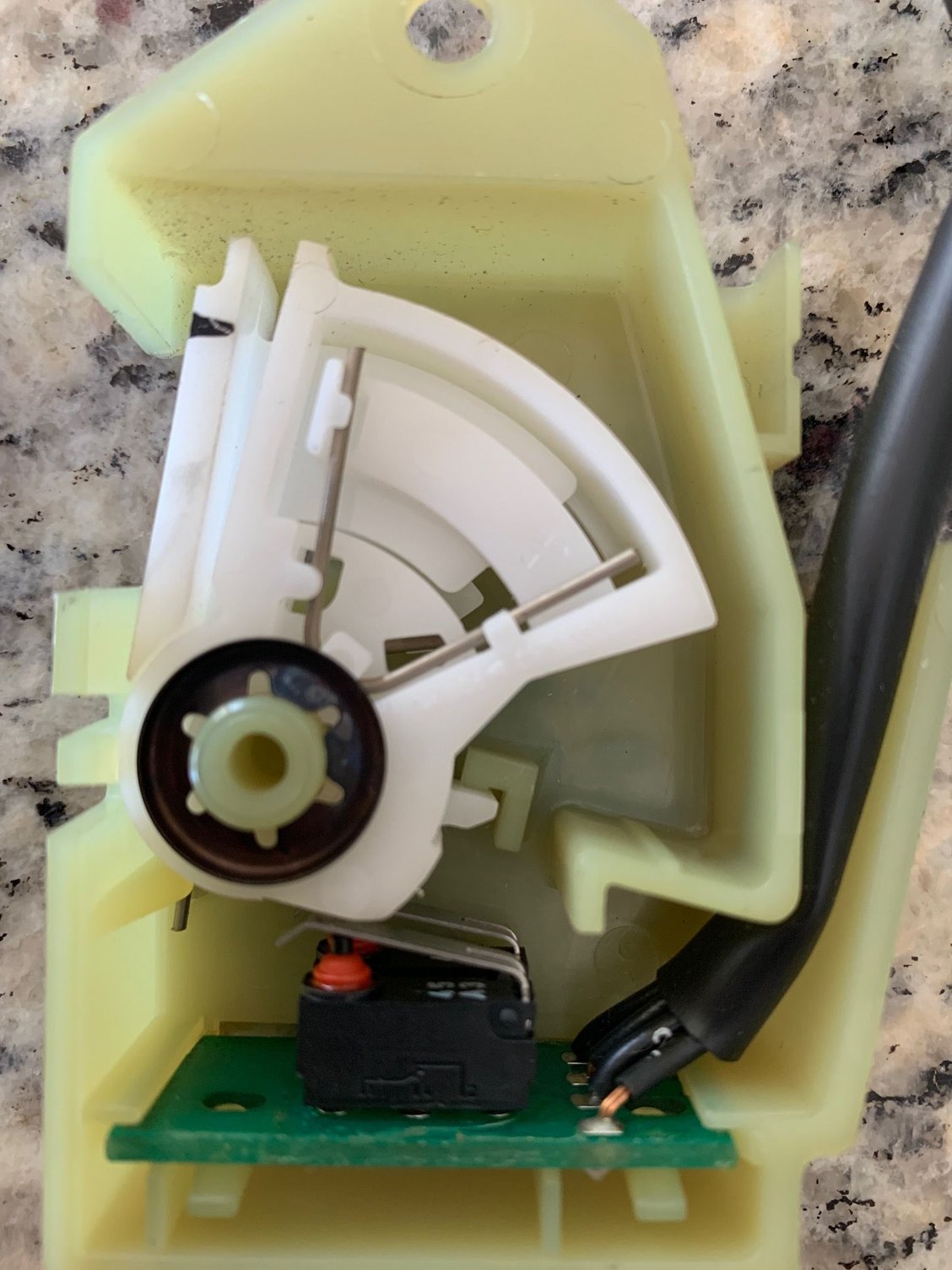

This is probably your brake switch. The adjustment is likely off, and the car "thinks" you foot is on the brake and will not shift up. You can test this by of course determining if your brake lights are on when they should not, or, as suggested above, move the shifter from "D" to "5" back and forth for each upshift.
For the fix, you need to look some pictures up, but the switch trigger has a built-in ratchet that need to be adjusted. This is tricky work mostly for access reasons (narrow footwell, up to the brake pedal). This is likely $0, though, if DIY.

Hey folks, well I spoke to soon on the battery and should have tried from stop more, fuly charged battery and stil wont upshift. I do have a brake switch issue with the "cruise unavailable" and "check rear lights" message on gauge. If starting from stop in 5 I still wrake wont upshift. I have ordered the brake switch (LJB 642 0BB)after taking it out to chect for corrosion, there was none. Not difficult but was tight under there. It would be great if the brake swich replacement fixes all but the shifting was fine even with these error messages prior. This shifting issue wasnt gradual, it just came on hard one day.
Start in D and gently accelerate from a stop, then gently switch from D to 5 and then back to D, back and forth, multiple times, as needed to reach the proper higher gear.
If you have your brake switch on hand, check the plastic teeth/ratchet on the trigger. That is the adjustment I am talking about. It is likely completely collapsed right now, and no longer makes contact with the brake pedal stem, hence your transmission thinks you have your foot on the brake.

Im wondering of we are talking about th esame switch. This is th eone I removed, is there a different switch behind the pedal that you are refering to?
The white area is actually two pieces that can be adjusted for actuation. (photo complements of member astromorg from post 22 thread: https://www.jaguarforums.com/forum/x...-171849/page2/

Hey Craig, on you pic I see the prongs are grabbed by a dark grey clip of some sort, Looking at my switch this isnt present. Is this the teeth you are mentioning?
