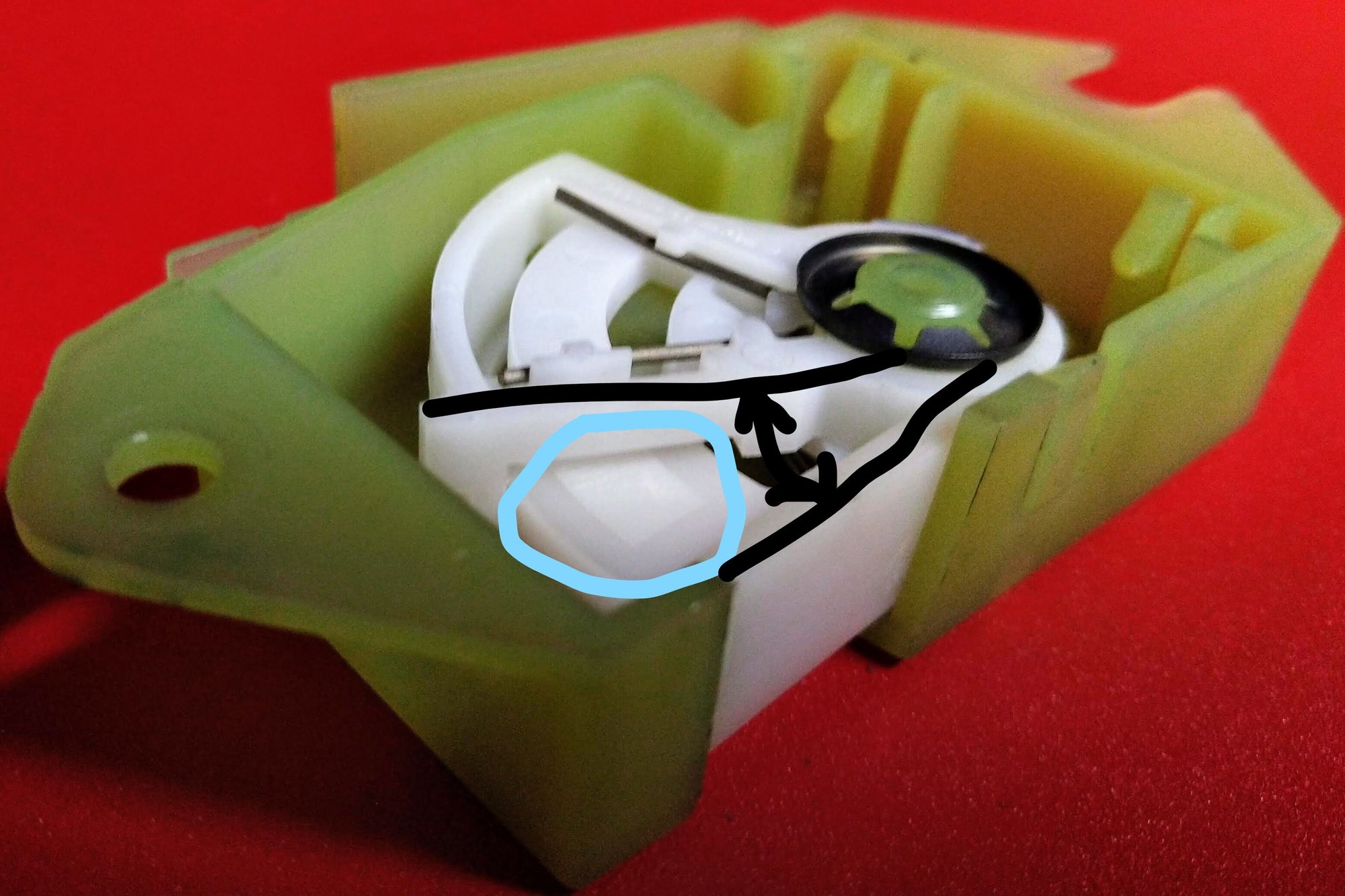

What you describe points 100% to the adjustment on the trigger of the brake switch.
The ratchet/teeth are in the area highlighted in blue. The purpose is to hold the angle highlighted in black.

Thank you!! You are the second person to suggest this so I have my fingers crossed. Also have the cruise unavailable and check light message which I understand is also do to the switch.. On my switch there is nothing holding the teeth so Im assuming they broke off causing the problem. Im handy to fix these things but not a mech, is there any harm driving in manual until my switch shows? Would it shift if I removed the switch?

A big thanks to Mr Fmertz for saving years off my life releiving stress with his correct assessment of a brake switch over the thought of a serious tranmission failure. Replaed on arrival of switch yesterday and I now have an auto transmission. However when I punch it at times it will hit 6000 and I have to pull off gas for it to shift. I still have "cruise unavailable" , from my reading of forums when I test the battery Im sure the voltage isnt where it should be, i beleive 12.5 volts. I have also seen many threads on replacing the switch on the forums, I did not go through the hood, I removed the 1 8mm bolt and just took the switch without the casing and then replaced with new one. Im not a mechanic but handy and at 6' 190lbs it was tight but still doable in and out in 15 minutes. Also to note I thought I would call the dealership and get a quote for a trans drain and fill just to be safe as many have written to do this with a 2005 and 48000 kms. The dealership would not quote it and said its a maintenance free transmission. I will have the volts checked Monday and will update.

You still need to mess with the adjustment/ratchet part of the switch to make sure it makes contact with the pedal stem when the brake pedal is at rest. It is a bit faint, but the switches can be heard clicking when engaged. In other words, the brake pedal stem needs to engage the switches when the brake pedal is at rest. The switches then need to click again as soon as you press on the brake pedal. With engine off and windows rolled up, you should be able to hear them pretty clearly click on and off as you press and release the brakes.
Other possibility is that there is some play in the brake pedal somehow, and the pedal moving around makes it miss the switches sometimes. Should be easy to check by hand.
In this situation, the rule seem to be that the transmission will not upshift if it "thinks" you have your foot on the brakes. It only knows that from reading the status of the brake switch.

Well happy Saturday problem solved! I want to share the sympoms so no yone else will go through what I did. fmertz nailed this from the start with the brake switch, I actually found one at a wrecker and installed the switch. Transmission did shift better but at times took to 5000 RPM's which just isnt right. Cruise Unavailble still came on and cruise not working. This AM I broke down and gave the dealership $236 Canadian which is actually cheaper than EBAY and after installing the car shifts perfectly and the cruise works. The stress of the last month wasnt worth the $236 and should have bought a new switch from the start with fmertz advice. It samazing the symptoms thsi switch causes and I can see an owner just trashing their car with a bad switch. Beware of this when buying from a wrecker.
