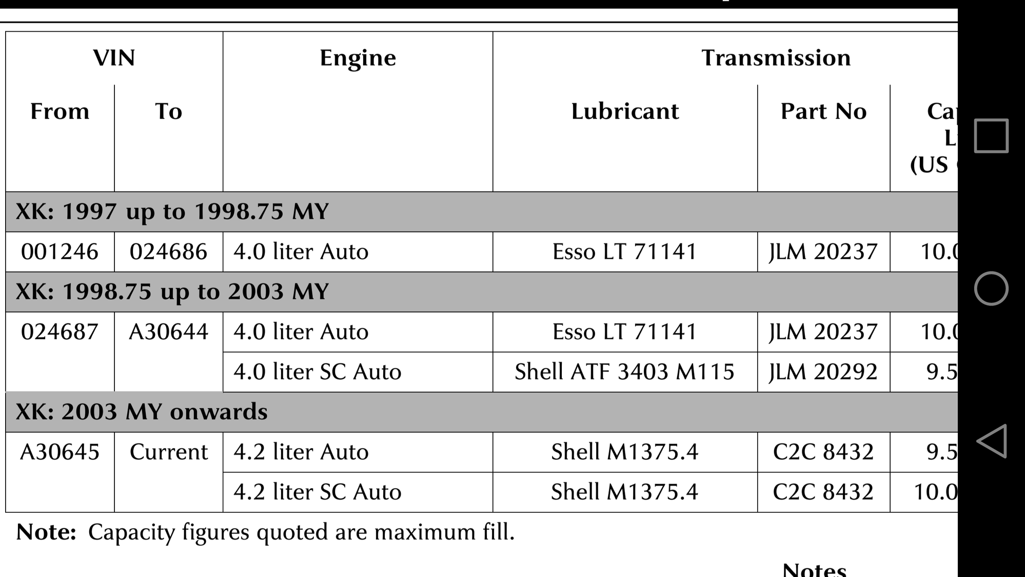

"Sealed for Life" equals 100,000 miles in manufacturers' lingo (that's the expected life of the automobile). Though there is no dipstick, it is a good idea to drain-and-fill a portion of the trans fluid about every 60,000 miles. Do a search of this forum for DIY procedure, or, find a good Indy shop who knows the transmission. If you replace the pan and filter yourself, there are several excellent offers on eBay and/or after market retailers. Here's the fluid spec for your model:
