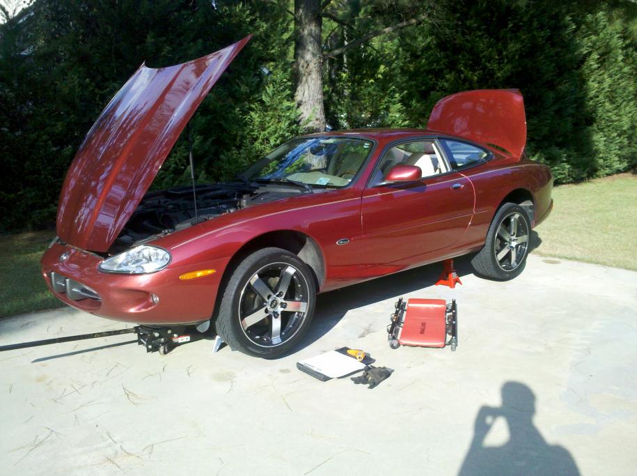

Drove car home, missing a shift or two along the way, and next day broke out friends tools and carefully followed TSB and ZF instructions as to how to add fluid (note: I was not relying on jack to support weight of car, as it might appear in the picture - only had it there as a back up in case jack stand(s) fell over). Tranny must be at just the right temp, not too hot or cold, so must use an IR temp tool as in picture. Bought one for the occasion and it worked great. Must also follow instructions to cycle through gears during fill process. Jr. Tech did neither of these things. I proceeded to add three more quarts of Mobil 1 synthetic fluid (FYI, it's the same company as Esso/Exxon, same specs (LT71141), so why does Jag charge 80 bucks a quart for their Esso-supplied version-?) Dropped car off jack stands and took her for a spin. Shifted properly, but still made some noise. Noise is not good in transmissions, I know. Guarded optimism till following day.
