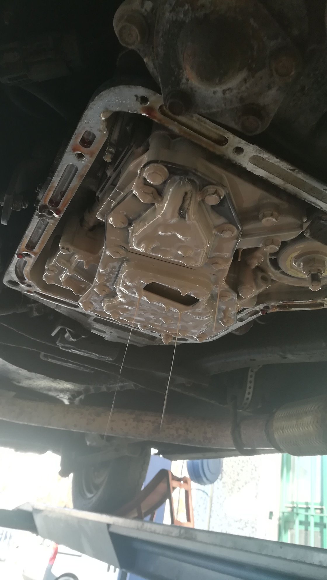

working with the flushing machine connecting to the pipes that go to the radiator is just what I will be doing next week at my beloved London Taxi. Unfortunately the radiator was corroded on the inside and it happened that suddenly the cooling and the autobox fluids were inexorably mixed in a frightening pink emulsion (look pic after removing the sump)
Now I have changed the radiator and washed the cooling circuit while they told me that for the transmission it is essential to work with that machine.
