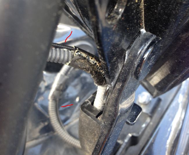

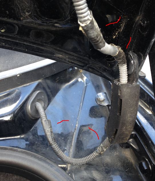

Default Pictures of wire loom in trunk
Here are some pictures of the wire loom in the trunk. It does not look good. There is electrical tape in four places. Highlighted in red. Never noticed it before. One of the wires is actually out of the loom in places. I do not see a break in that wire so it may not be the problem. If this is the problem I will have to find the break. I wonder who did this. I think the maintenance work on the car done by the previous owner was done by dealerships. I can not imagine either Jaguar shipped the car like this or that a dealership would do this. Bit of a mystery. How many wires are in the loom. What do they control? Thanks. Jack
Attached Thumbnails Trunk Button inop - any ideas?-jag-1.jpg   Trunk Button inop - any ideas?-jag-2.jpg   Trunk Button inop - any ideas?-jag-3.jpg   Trunk Button inop - any ideas?-jag-4.jpg   Trunk Button inop - any ideas?-jag-5.jpg

Old Mar 28, 2015 | 09:41 AM
RaceDiagnostics's Avatar
Posts: 1,854
Likes: 987
From: UK
See here how to fix your problem.
https://www.jaguarforums.com/forum/x...-button-74403/
