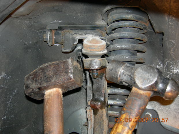

One method suggested to me years ago was to use 2 x BFH - one on each side of where the ball joint taper locates (see attached) with some pressure assistance from a tool similar to the one RJ linked to.
Works well only if you can get at both sides, mind.
Mike
