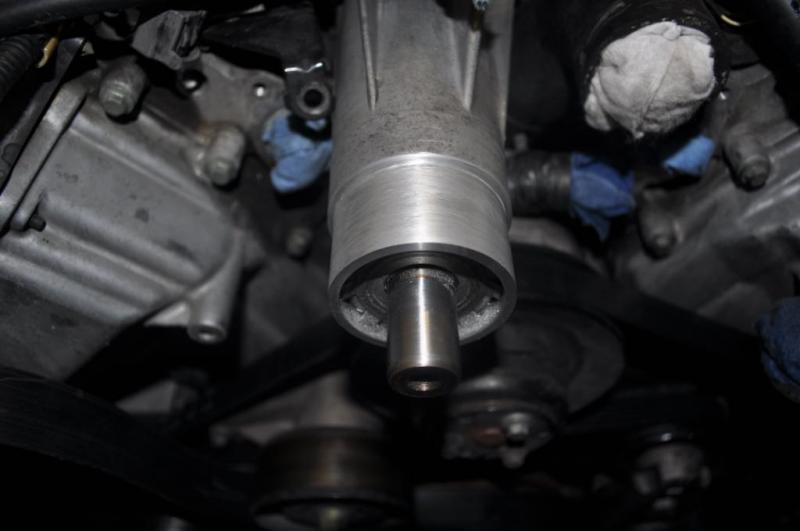

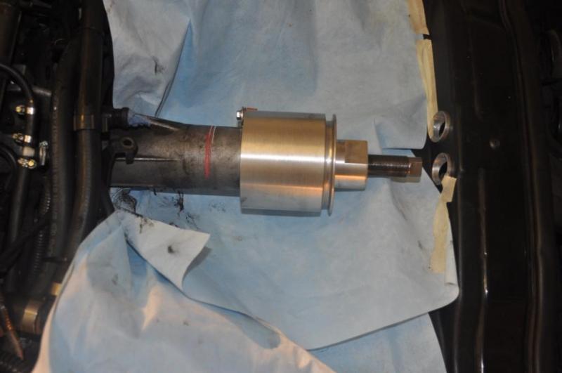

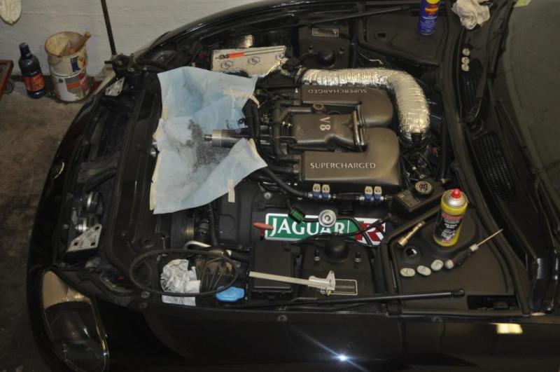

this is my invention to make a precise installation of the upgrade pulley.
Enjoy....
Attached Thumbnails Turning supercharger kit for the new Upgrade pulley-dsc_0035.jpg   Turning supercharger kit for the new Upgrade pulley-dsc_0040.jpg   Turning supercharger kit for the new Upgrade pulley-dsc_0041.jpg   Turning supercharger kit for the new Upgrade pulley-dsc_0053.jpg   Turning supercharger kit for the new Upgrade pulley-dsc_0048.jpg

Quite inventive.
Is this a tool that you invented or a novel adaptation of something that you already had?
I, for one, would be interested in pictures of the inside of the tool and how you mounted it to the S/C shaft to keep everything centered.
Thanks for sharing!

hi. yes, i invented this tool and i had doing all the pieces at lathe.
I will not show anything else because in Italy are the only one with this particular piece and see if some owners of Jaguar will want to do the work by myself.
copyright! :-)
the central axis exploits the internal thread of the shaft of the pulley

Yes, we can do this kit . i send you an private message for price.
After installing the kit, the job is ready in about 20 minutes to install the new pulley

Very ingenious, a sort of longitudinal tank cutter.
Surprised you could get away with only one cutter and get such a good finish.

White is correct and beat me to it. You never ever use anything but the sc pulley tool, kenne bell and others do make them and not expensive. Especially compared to trashing the blower. I would either cut it off or remove the blower press the pulley off, machine the snout and install new new pulley along with new hoses under the sc. This is what i usually do and this tool would be great for a shop not looking to remove the sc or needing to do the hoses underneath. I would never recommend heat as to the potential damage from transferrance of too much heat into the snout bearings and seal. Patent it and sell them
