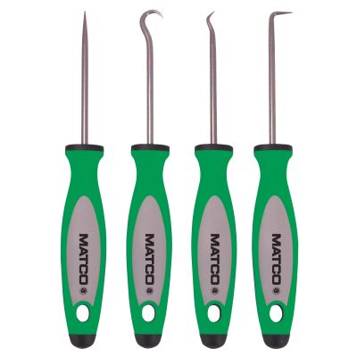

The hidden screws are under the leather bit between the hand cup and switches. I did a reply to a post about how to remove the panels early on to joining this site. I'm searching the logs for that. Found it!
Only because I could not find this on line anywhere and had to stumble thru this on my own. These are the tools you need. KD door panel removal tool. ( if you do not have this you can use any 90 degree angle spring steel tool.) This KD tool is a small tool about the size of a 6" putty knife with no handle and has a 90 degree bend on one end, all of the edges are very smooth and rounded. Phillips head # 2 screw driver about 8" long, and a 90 dergee angle pick kind of like a dental tool. Remove the screw plug from the door handle socket using the pick. Remove phillips screw and escution will become loose. Lift handle to remove escution. If equiped remove speaker grille by rear view mirror. there is a stud on the winshield side and a clip on the door mirror side. You will want to squeeze and pull. Squeezing will release the clip and pulling will disengage the stud. BE GENTLE. There is no need to disconnect this it can lay off to the side. Inside the door handle trough remove the black rubber insert. This will reveal a single screw remove this screw. The next two screws are hidden under the power window switch. There is a leather wrapped trim cover held in place with a christmas tree clip just under the power window switch. Pry this out using the KD tool. This exposes another phillips screw. Remove screw. Next pry up and out the power window switch. Be careful this little ******* has metal barb clips to hold it secure. If you are not carefull you could nick the leather. Under this switch you will find another hidden screw. Remove screw. The last two screws hold on the speaker cover. They are exposed on the bottom of the speaker grille. Remove these two screws. Next insert the KD tool starting at the bottom of the door panel on top of the weather stripping and underneith the door panel and apply anglular pressure until you hear a pop. there are 8 studs to release from their sockets along the both sides and the bottom of the door panel. I used the tool and slid it along the panel until I hit a stud, then pry. The studs are located about 1.5" off the edge of the panel. Once all are released the panel will be tied to the door only by the wiring of the courtesy light which you may or may not choose to remove. Now do your thing and throw it all back together!

KD tool, Acton tools, Matco pics. These were the style tools I used.
