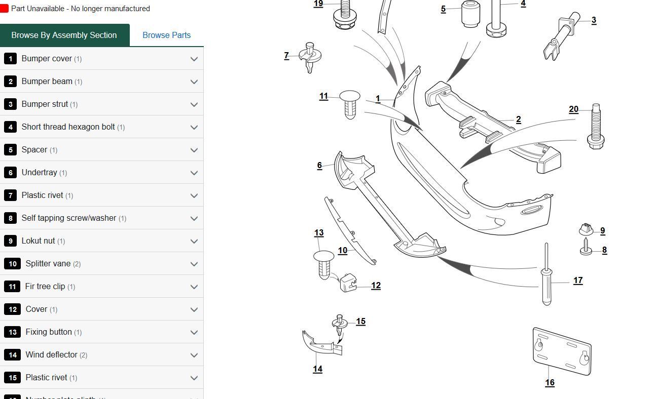

From: Winchester, CA
All models came with 1 undertray in the front. Piece 6 on the attached parts drawing. It basically provides rigidity to the bottom of the front bumper cover.

JaguarXKR,
Your 2001 XKR "Silverstone" came with part #'s 6 and (2)14's.....Jaguar changed to a large single Undertray on the 2005 & 2006 models.....In most cases, your (14) Wind Defectors are normally still in position, It's the actual Wind Deflector that the mechanics forget to replace or throw away.......

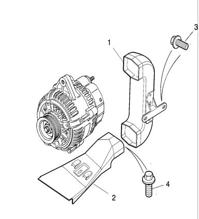

The other bit that always seems to vanish is the little duct that bridges between the undertray and the alternator cooling duct. It has to be removed to change the oil and for some strange reason has a tendency to end up in the mechanics trash can.
Is the cooling duct shown above?

Originally Posted by bcprice36
JaguarXKR,
Billy Clyde
From the picture above I am not sure what number 14's actually look like.
No, not shown above. What I am referring to is #2 in the image below.
The front edge hooks onto a cross bar and there is just the 1 bolt to hold it in place.

JaguarXKR,
#14 is about a foot long and fits over in front of each wheel.......

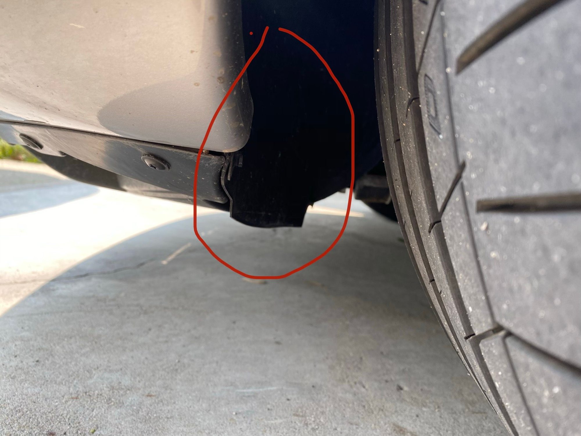

JaguarXKR's Avatar
Posts: 883
Likes: 63
From: Illinois / Wisconsin

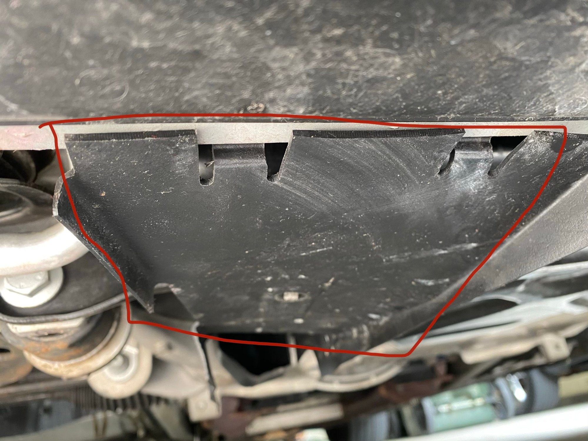

Old Sep 16, 2020 | 01:31 PM
JaguarXKR's Avatar
Posts: 883
Likes: 63
Looks like I may be missing mine...
Actually..I think mine is still here..
JaguarXKR,
Billy Clyde
Is this what you are talking about?
Old Sep 16, 2020 | 03:10 PM
ccfulton's Avatar
Posts: 2,953
Likes: 1,120
From: Phoenix, AZ USA
Yep, that's it.

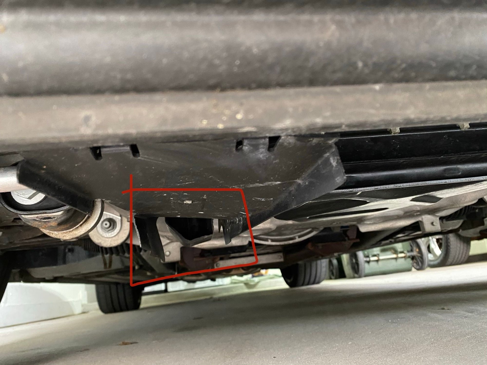

Old Sep 16, 2020 | 07:32 PM
bcprice36's Avatar
Joined: Feb 2017
Posts: 2,089
Likes: 923
From: Houston,TX
Charlie is right! It looks like you still have them! My 2005 has a large Undertray that covers the Whole area from the front back to about where the #14's are...In other words, it's much larger than yours! If the Mechanic needs to work on the Oil Cooler or anything up front, they have to take it off......It's easy to forget having to put it back on......at the end of the Day....So after my original one disappeared,,..and I had to buy another one for $380.00.....I look before I leave the Shop, now! I've wondered how many 2005 and 2006 XK's still have one....?
