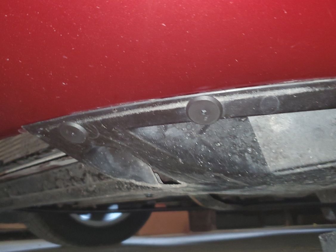

In trying to repair the wind deflectors on my 1997, I noticed some of the rivets holding the under tray to fascia were loose. Further examination and it seems the front of this car was apart before, and the undertray, was actually on the wrong side of the fascia / bumper cover.
I bought some plastic rivets from Harbor freight, but none of them seem to be the right size. As near as I can measure, the old rivets were about 6.25 mm, but given how the front end was assembled I am not counting on them being original. The options from Harbor Freight are 5mm, and 6.6mm. The 6.6mm will not fit through the bumper cover holes. I have the 5.5 in there now, but they seem likely to fall apart.

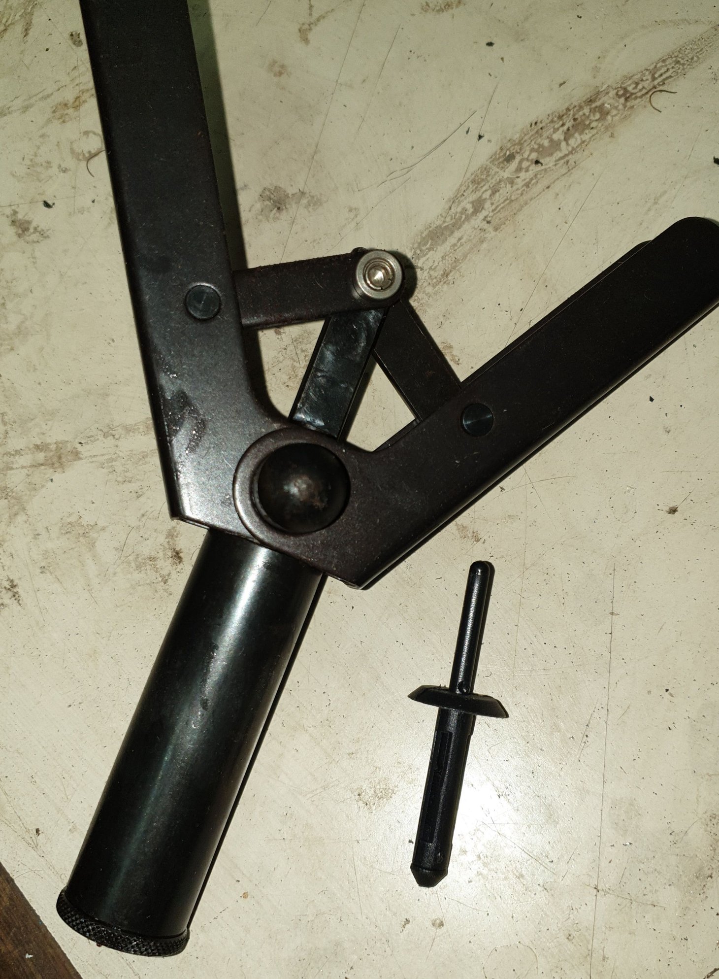

I just bought a kit on ebay, came with a selection of rivets. Those l used are 30mm actual rivet length, head 17mm and body 6mm. You may get away with 6.25 at a pinch.

That looks exatly like the riveting tool that I got at Harbor freight. I bet it is the same kit, and rivets.
https://www.harborfreight.com/hand-r...ets-97757.html
