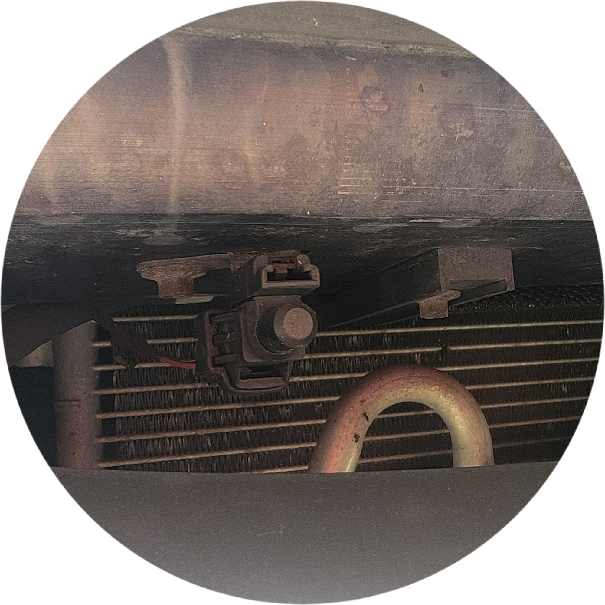

I cannot find any reference to the pictured sensor in my 2004 X100 convertible. It does not have adaptive cruise control.
Pictured is right side of radiator air intake, below the central cross bar.
AC condensor and oil cooler line are in the background.

could be air temp sensor
Jack
i believe it is

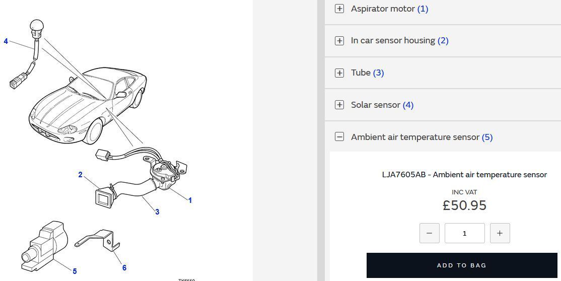

Jack and Z are correct, it's the Ambient Air Temperature Sensor referenced by the Heating & Cooling system. See Part 5 in the diagram below:
Cheers,
Don
