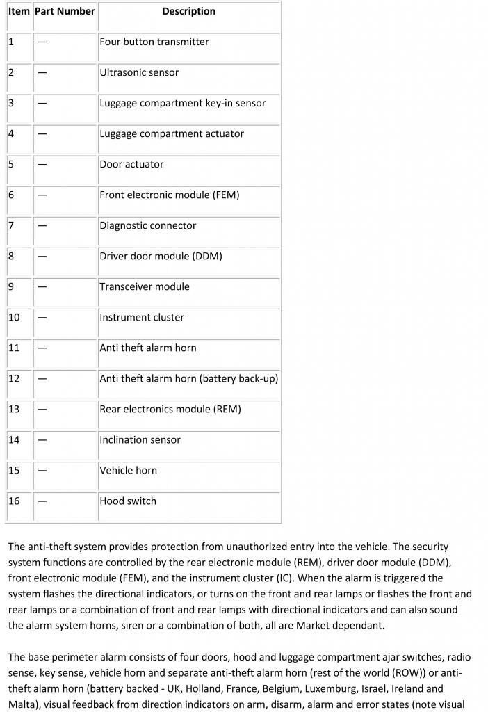

Don, the sensor IS there but wires not attached. May be good but if not I have a spare. If you have a pic of the "Bonnet Closed" sensor and where it hooks, I would appreciate it.
Thanks, Bob
Hi Bob,
I'm not sure about the "Bonnet Closed" switch. The closest thing I could find in the Workshop Manual (available for download in the HOW TO thread of this forum) is the "Hood Switch." See the illustration below. Hope this will help you figure it out.
Cheers,
Don
Attached Thumbnails Ambient Air Sensor on 2004 XJ8-x350_-electrical_385.jpg   Ambient Air Sensor on 2004 XJ8-x350_electrical_386.jpg
Old Apr 23, 2014 | 11:36 PM
meirion1's Avatar
Joined: Nov 2009
Posts: 3,145
Likes: 804
From: The beautiful Mornington Peninsula in OZ
You are very "warm" Don.
There are two hood latches but only one has the open bonnet switch and
is under the latch which is covered with a sheet metal cover.
You can replace switch or bridge with a piece of wire to disable alarm message.
Very common fault on this Jag.

Originally Posted by meirion1
There are two hood latches but only one has the open bonnet switch and is under the latch which is covered with a sheet metal cover.
Great info, meirion1! The (U.S.) manual illustration seems to indicate that the latch with the switch is the one on the right when facing the car from the front. Does it vary depending on whether the car is RHD or LHD? On our LHD car, the hood/bonnet release is at the left A-pillar. The cable from the release lever runs to the left hood latch (or the right latch when viewing from the front of the car), and either the same cable or a separate cable continues on to the right latch (left when viewing from the front). Would it be just the opposite on a RHD car?
