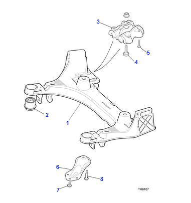

None of those. The bolt goes through item 2. but is not listed...
Old Dec 1, 2023 | 06:23 AM
michaelh's Avatar
Posts: 4,814
Likes: 3,029
From: Jersey, Channel Islands
Not entirely clear from the diagram - #8 goes through the mounting bracket 6 and subframe bush 2 into the chassis.
Part # is JZB100095, M12x85. Jaguar will sell you them for a paltry £21.11 each:
https://parts.jaguarlandroverclassic.../brand/jaguar/
...but, as noted above, you should be able to source for rather less.

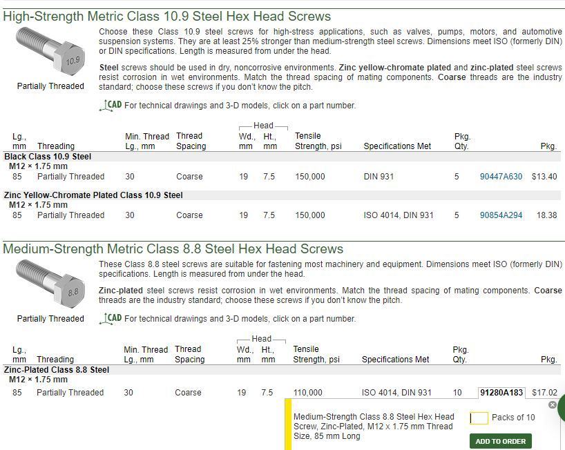

Originally Posted by michaelh
Part # is JZB100095, M12x85. Jaguar will sell you them for a paltry £21.11 each: ...but, as noted above, you should be able to source for rather less.
All you need to do is post dimensions, that michaelh has kindly done. This is a common screw one source is McMaster at $13.40 USD x 5 or $2.68 each in black.
https://www.mcmaster.com/products/bo.../length~85-mm/
Attached Thumbnails Unobtainium.....-91280a183_medium-strength%2520class%25208.8%2520steel%2520hex%2520head%2520screwx.gif
