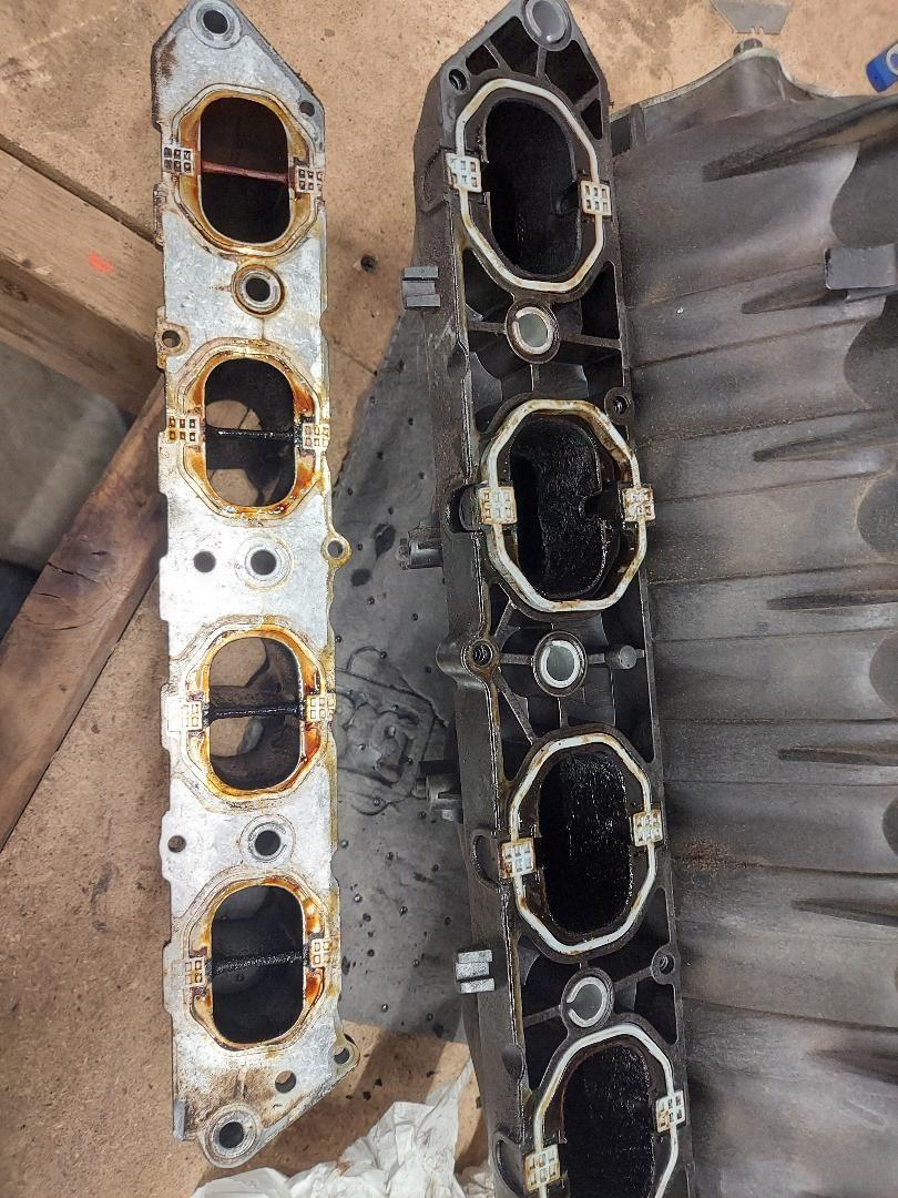

Today was productive. The oxygen sensors are done and the cam covers are re-sealed and back on. I even found a hack job on the wires to the LH VVT solenoid and repaired that. When I separated the intake aluminum runners from the plastic plenum this is what it looked like. The presence of the oil doesn't surprise me considering the 111K miles on the engine. But the amount that has apparently traveled through the seals tells me that there has been a leak that has gone undetected thus far. Thanks to michaelh for helping me sort out the part number of the right seals.

Good progress, well done....
