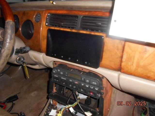

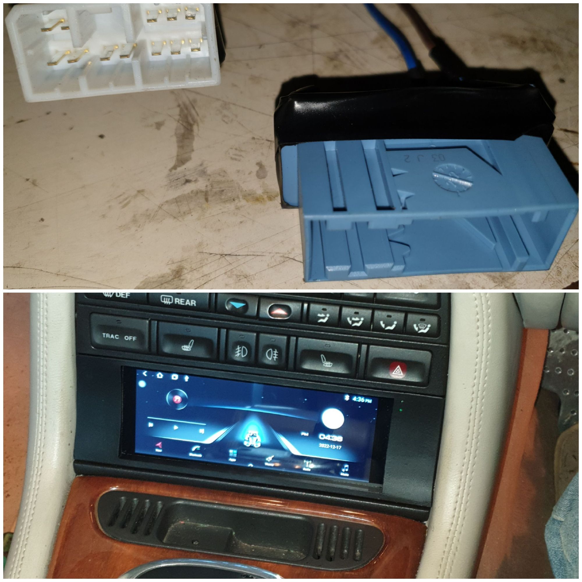

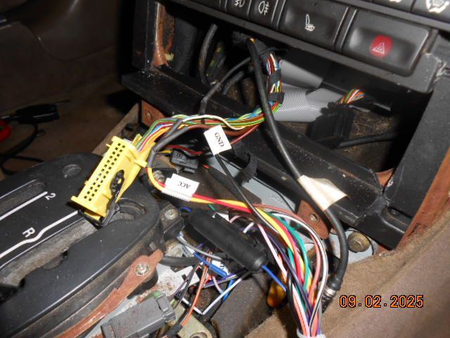

I purchased a JOYING stereo system to install in my car. So far, so good. I was able to install the stereo down where the original Alpine unit lived and had a piece 3D printed to install the screen where the triple gauge cluster was. Looking at the schematic for the entertainment system. I have the Premium system, with the AMP in the trunk. My problem is; How to connect the speaker wires from the new unit to the wires in the yellow connector to get it functioning properly. Anyone?
YELLOW CONNECTOR FOR SPEAKERS
SCREEN INSTALLED
STEREO INSTALLED WHERE OLD ALPINE UNIT LIVED

Sorry, 2001 XK8. it is not added to my profile as yet.
As stated in my previous post, what I need to know is how to get the radio signal to the AMP. I have the 1999 MY schematic and based on what I am seeing, what I need to do is to get the signal to the AMP. The schematic shows all the speaker wires are coming off the AMP. It also shows the following wiring from the original radio.
Orange, Black, Yellow, Green, Blue, and Red going to the AMP from the radio but it does not say which is left or right or which is + or -
I used the wires from the original white connector to power up the Joying stereo but I now need to get the signal to the AMP to get the speakers working.
I beleive I have to use the RCA outputs to send a low level signal to the AMP, since the signal from the speaker wires will be too high. I don't know if this makes any sense but I don't want to butcher the existing wiring nor do I want to rewire the whole system.
Throwback mentioned in his post that he looked into doing this Quote "I did look into how to connect into the stock harness to the amp, identifying wires and either tapping them, or cutting the connector and creating new interconnects that way. " Hopefully he will chime in on this issue.

@dibbit I guess that you are not understanding what I am trying to do.The yellow plug at the OEM radio location is not used to go directly to the speakers. It used to power up the AMP, antenna, steering wheel controls, SatNav etc . There are six wires: Orange, Black, Yellow, Green, Blue, and Red going to the AMP from the radio harness. So, I have to use the low frequency signal via the RCA ports to fire up the AMP.
What I need to know is which of the six wires are + and which are -
In this scenario you cannot use the speaker wires unless you rewire the car from dash to trunk and bypass the AMP.
I don't want to take the car apart to run new wires unless there is no other alternative.
Not sure that l totally understand here, correct me if l misunderstand but... the yellow plug shown looks like ic20 (yellow 26 way) this has nothing to do with speakers. Speaker connections were through the white 12 way, ic19 in the standard system ( the one you used for power), premium system amp connections were through the alpine proprietary plugs.
The yellow connector for speaker connections you want is ic1 (20 way yellow) under the console cubby.

In response to dibbit and stevis05, your inputs are greatly appreciated. I am pretty ignorant as to the workings of the entertainment system on my 2001 XK8 hence all of the questions even being unclear most of the times.
Given that the factory amp will not work with the aftermarket head unit, I opted to go with the AIH-JAGRCA and ARH-JAG2P to get the new system going. The reason for the query about amplifiers is simply because if I want amplified sound, those who have already done so would have done the research and would know what works and what would not work. SO PARDON ME. I am not looking for the BOOM,BOOM sound, just something to produce quality sound. My car is a convertible and no massive sub woofers will be involved. Replacement of the current speakers will be done cause theyare 24 years old. I know that the specs for the new head unit is critical but I opted not to post it as I do not think it is critical to what my original query was:
"HOW TO GET SOUND THROUGH THE SPEAKERS VIA THE CURRENT WIRING OF THE XK8. Nothing more. Once I figure out how to get that done, the rest will fall into place.
I contacted Monkeybrain who installed the same unit I am installing in my car and he told me he used a 12 pin connector from InCarTech in the UK but because of the tarriffs issue in the US that option is off the table so I researched and went with the patch cables from Discount Stereos here in the US.
When the patch cables get here, I will know what the next steps would be.
Since I have to remove the rear seat to get the reverse camera into the trunk area, I may look at dibbit's idea to run new wires at the same time if need be.
@ michaelH: Thanks for the info re the 2001 EG. I found it and it is indeed different. However, the 2001 schematic shows 8 speakers but my car has 10 speakers. I guess they did not include the 2 tweeters. Nonetheless, it will work for me.
While I am waiting for parts, I am working on moving the 3 gauge cluster (volts, oil and clock down to where the original radio lived. I am in the process of extending the 20 pin (only 13 used) connector for the cluster by approx 18 inches rather than dismantle the dash. Will post some pics later today.
Are you sure you've on the correct page, premium in car entertainment, fig 16.2 shows tweeters. Previous page is standard in car entertainment and does not show tweeters.
Old Sep 11, 2025 | 05:50 AM
sanchez's Avatar
Joined: Jun 2015
Posts: 1,514
Likes: 687
@baxtor You are correct. I was looking at the wrong schematic. I have a printout of the 2001 MY schematics so I will be following that going forward. Thanks for the correction.
