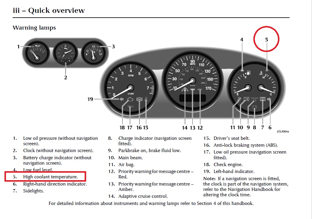

Now this is going to sound truly naff, but let me check a point. You are referring to the oval light which is above and outside the scale, and not to the red rectangle on the end of the scale? That red rectagle is unlit, though sometimes seems so, since it it appears to glow slighly from the dasboard lights. That caught me, once.
Old Aug 24, 2017 | 02:45 AM
Likes: 17,009
There seems to be some debate over exactly which red light this is .......
...... item 5 - the red high coolant temperature warning light?
If so, it's reasonable to assume either:
1. the temperature was actually above normal
OR
2. faulty ECT sensor/out-of-range signal to ECM
Always essential to keep a close watch for any sign of overheating on the Jaguar V8. This would encourage me to monitor actual temperature and, as has already been said, the only way to do this is with Realgauge, ELM or Torque app.

Now I really am unsure, On the way out to get the paper this AM, I got inside the car and turned on the ignition and saw the #5 light as mentioned above, and also the RED rectangle scale. It was hard to tell which one was "lite" while driving yesterday. You can say with certainty that I am confused (not uncommon for me), so will have to drive around and see which one came on--or looked like it did. Either way, the suggestion for a RealGauge will have to be looked at again. A web site would be appreciated.

Certainly you can disregard the red rectangle. This glows from referred lighting within the dashboard and, since the dashboard lights are always on with the ignition, it may appear illuminated even if your car lights are off. There is no bulb behind that red rectangle. The lamp referred to as no. 5 is another matter -is it on when you drive? I also have a possible overheat question, and have started a thread on this!

Well went out of town today in the XK8 and must confess that the "Little Red Light" I was concerned about was the rectangle light as mentioned by "Diddion" above, I had just never noticed it before, or the lighting was just right for it to look as if it had come on. The other red light never did come on. Of course this is after I ordered the "RealGauge". Oh well, once I install it, I'll know the temp all the time.
