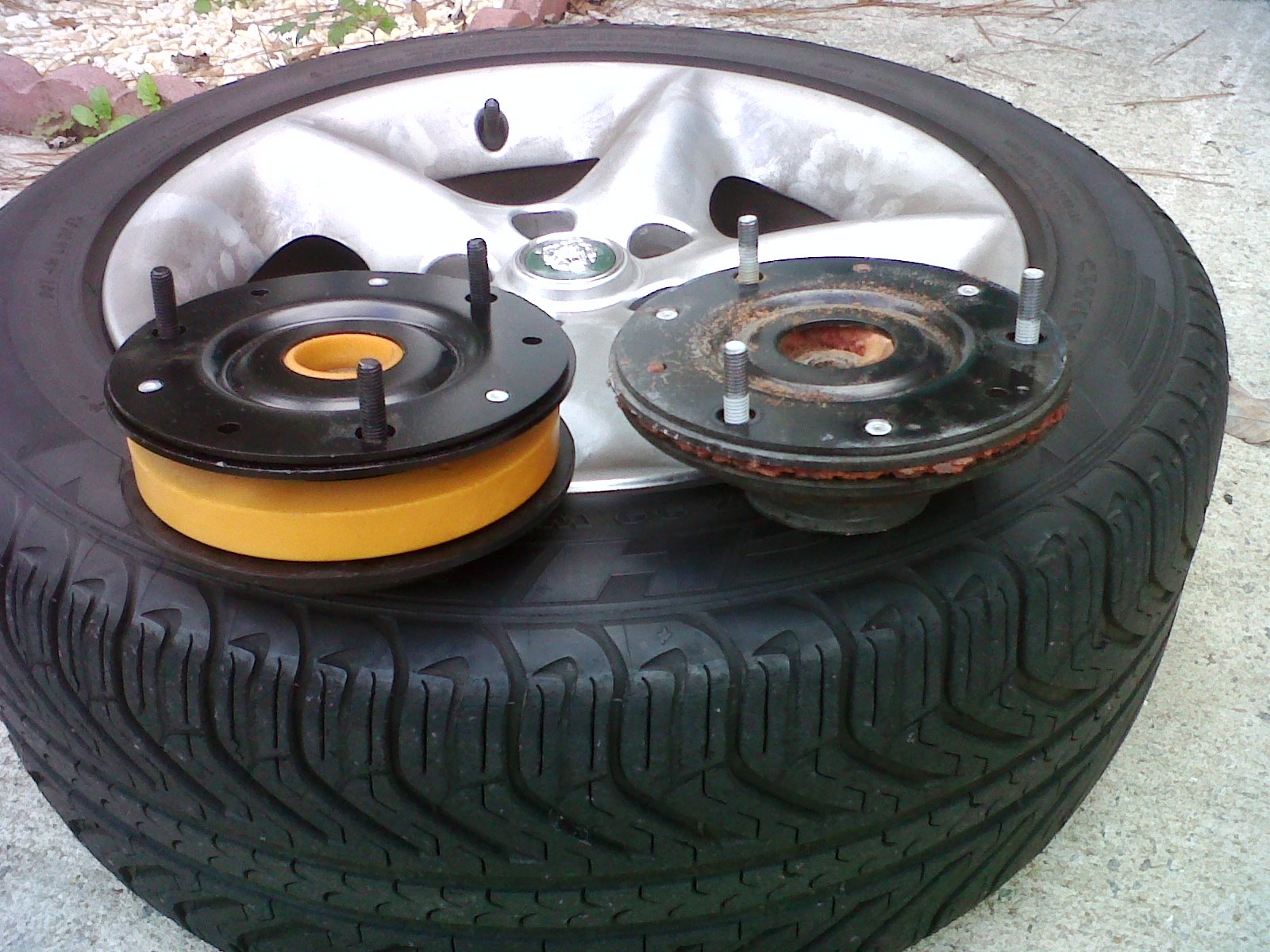

well project has started but didn't get as far as I wanted today. Oh well - driver side upper wishbone is off and shock/spring removed. Here are pics of the old and new shock mounts along with a pic of the upper ball joint which is being replaced. I guess I should have just bit the bullet and picked up new shocks and a few other items - shocks are ok but lower shock bushing is in bad shape, lower ball joint boot is cracked - looks like it will be a little bit at a time. Will take a few more pics tomorrow and hope to have at least this all done so I can drive it Monday.

The metal on the older shock mounts looks pretty much intact. Could steve or any of the other guys here fab and sell a kit made out of something which will last longer? I mean, I'd be happy if I could buy the bushings alone and fit them in. It looks like I'll be fabricating them myself, but I don't know what the most durable and cost effective material would be for this application.
