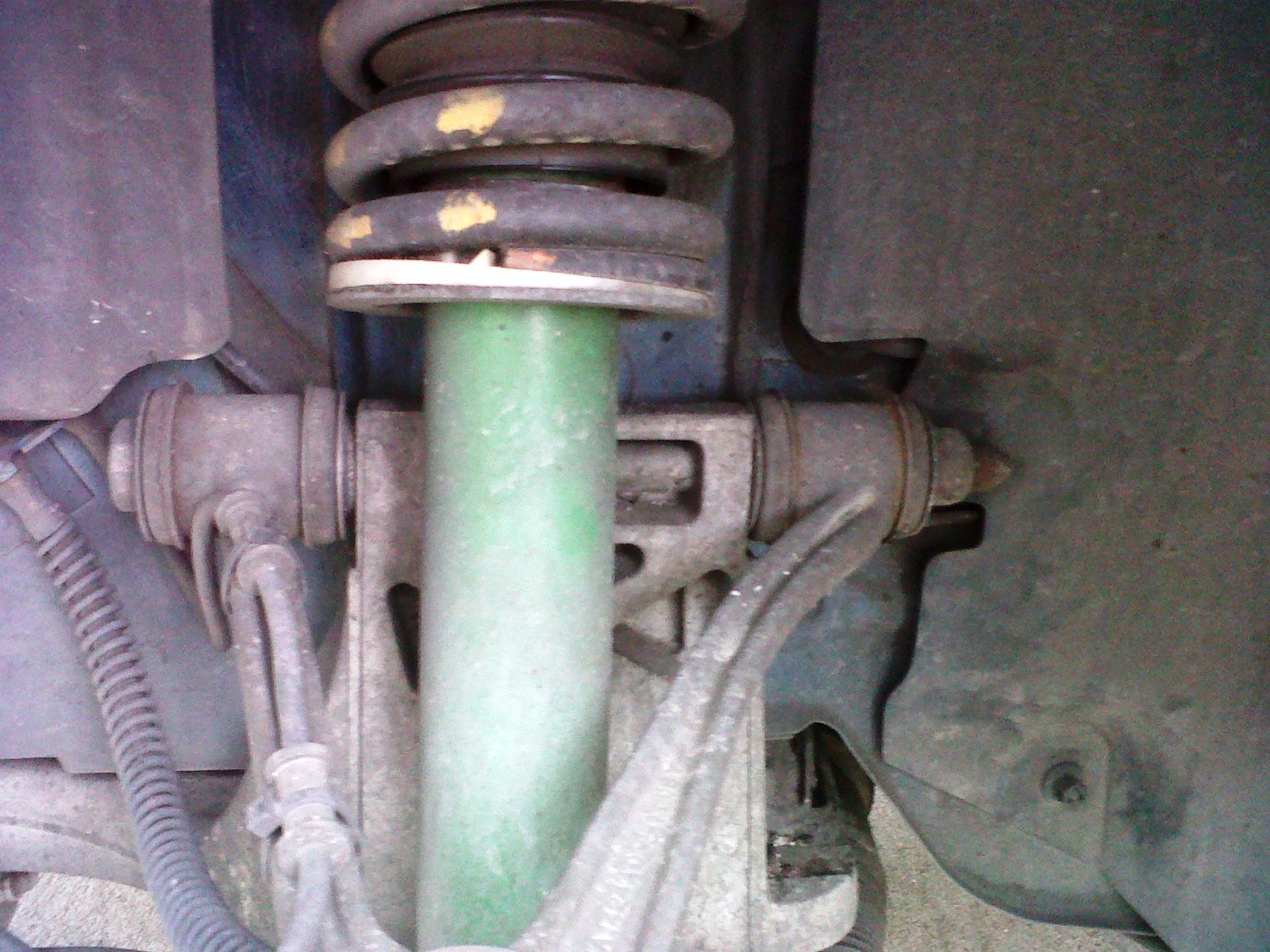

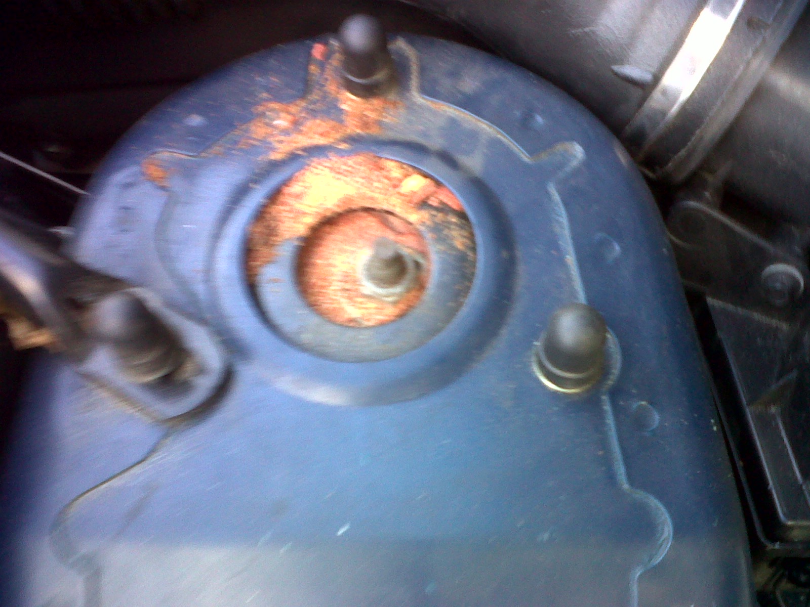

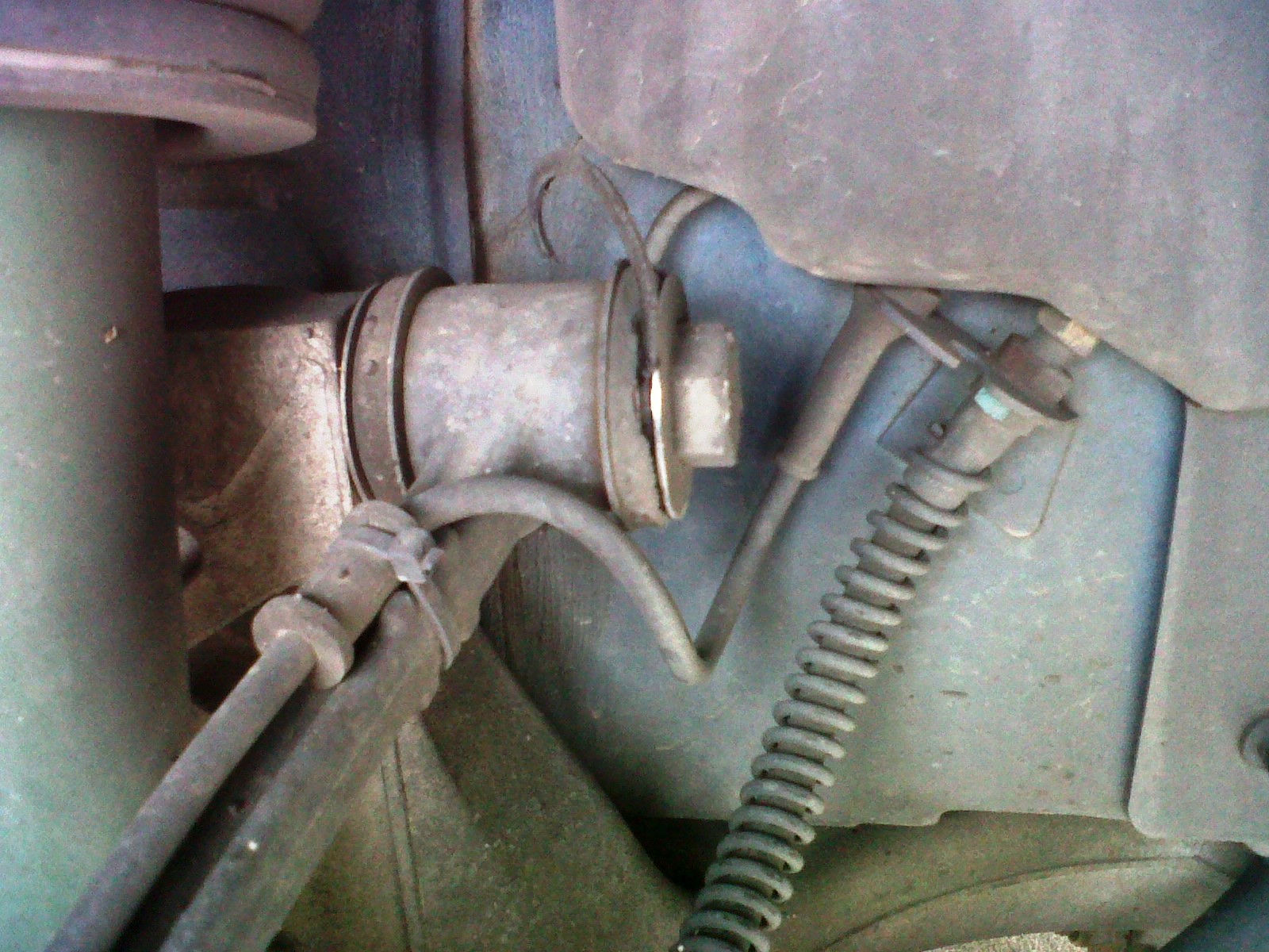

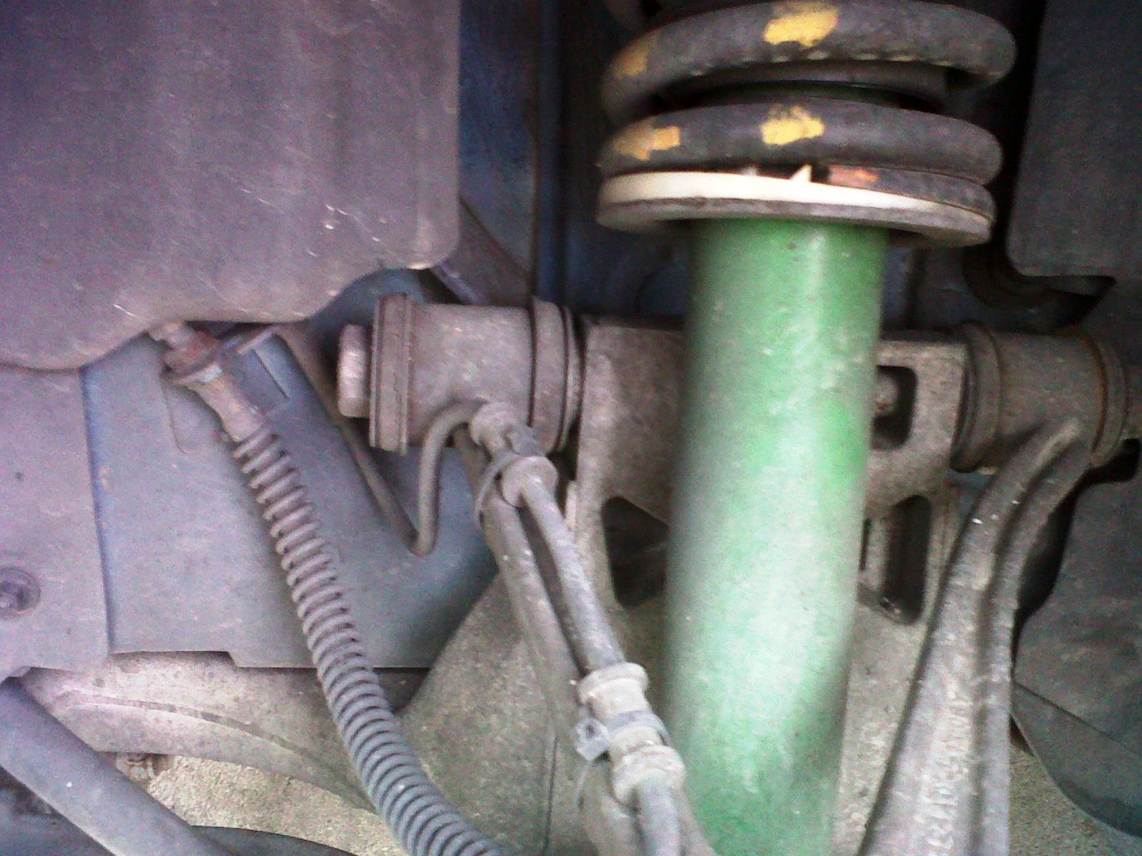

today's mail - now I won't have to listen to the cricket orchestra anymore! Here are a few pics of the current situation and the new mounts.

well - jacked car up to replace the upper shock mount but soon discovered I need to replace the upper wishbone bushings and upper ball joint - parts on order - looks like my weekend will be busy.

no impact on height but does impact alignment and since you have to take apart the upper wishbone to remove the shock/spring assembly - only makes sense to replace what little I have left

when your old one is collapsed, it is alot lower. So much so that decent bumps will cause the tires to hit the wheel well liners. Theres has never been one i did that has an alignment in spec after replacing the upper mounts
