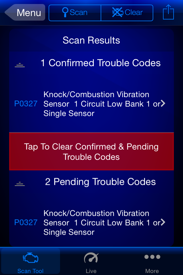

Default Code Reader Lemur Bluetooth
Feeding back, I went with the Lemur Bluetooth, from Amazon, which linked to my Iphone. Software comes free by scanning the code on the device when it arrived. Worked straightaway. No problems with it at all. P0327 Knock Sensor
Attached Thumbnails Urgent: code reader for non-professional-lemur-xk8-scan.png
Old Dec 2, 2015 | 04:47 PM

time for new ones probably.
