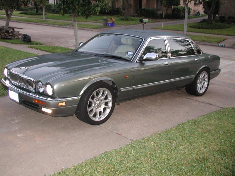

Brutal's Avatar
Joined: Sep 2008
Posts: 7,255
Likes: 2,209
From: Damon /Houston, Texas
like these on mine
Attached Thumbnails Urgent question - Staggered tires-p1310008.jpg   Urgent question - Staggered tires-p9300002.jpg
