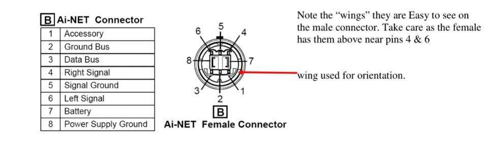

The audio streaming has to be connected separately - either at the CD player end, or the cassette player end. There are various hacks for this described on this forum. The T605 has the advantage of having a stereo audio pass through function where it will automatically switch between the line input and the Bluetooth streaming. On my car I spliced into the CD player audio cable (photo below), so that the CD player works as normal when the phone isn't connected/streaming and automatically switches to the Bluetooth source as soon as the phone starts streaming.
CD player cable pin outs:-

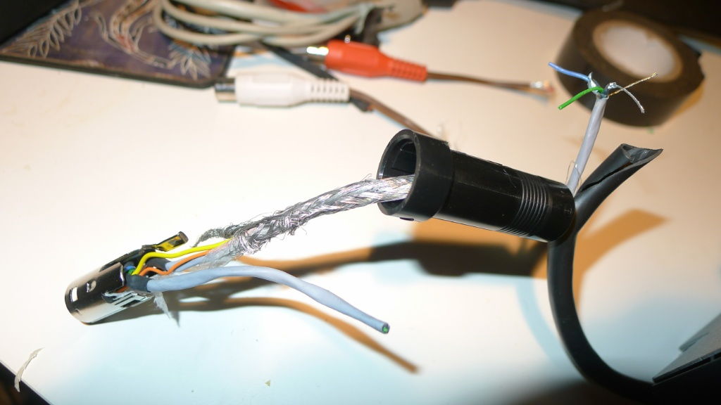

Well I have decided to go the easy route. I'm just going to unplug the cord on my CD player. And I was just at my mom's house clearing out things from our house fire, and I found the CD changer my dad got me when I was in high school. And guess what it has the same type of hook ups 😁. So I think I'm going to set down and make me a aux port. Wish me luck cause I just taught myself how to solder 2 weeks ago.
