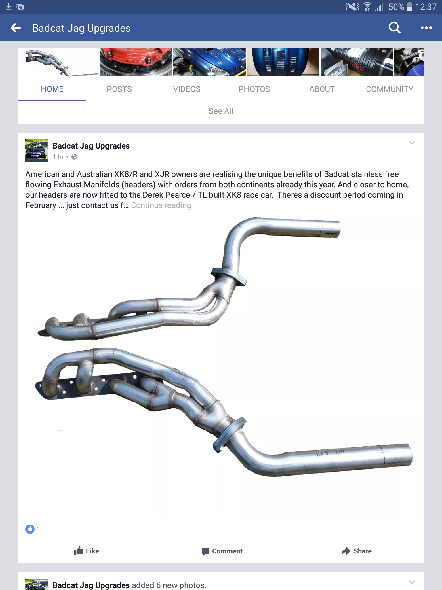

Nothing to do with me. But might be of interest to others.

Got a link for these?

It is a UK based business. Unfortunately, their website doesn't say how much they are, but directs you to call or email for price. Usually that means $$$.
http://www.badcatjagupgrades.co.uk/product-01.htm

Judging by the photos the cylinder grouping of the exhaust manifolding is incorrect and will cause charge robbing. The cast iron logs will be an improvements. As usual someone is probably mixing up restriction with tuning.

The prices are posted under the photos, I'll just stay stock with mine.

Although steel headers will slightly increase performance if properly designed they are noisy and always eventually leak.. Cast iron is used for exhaust manifolds because it expands very little with heat and absorbs combustion noise. Unless you really need the benefits of headers, why.

I couldn't agree more! If you want Headers, send your Manifolds out and have them Ported, Honed and Ceramic Coated....
