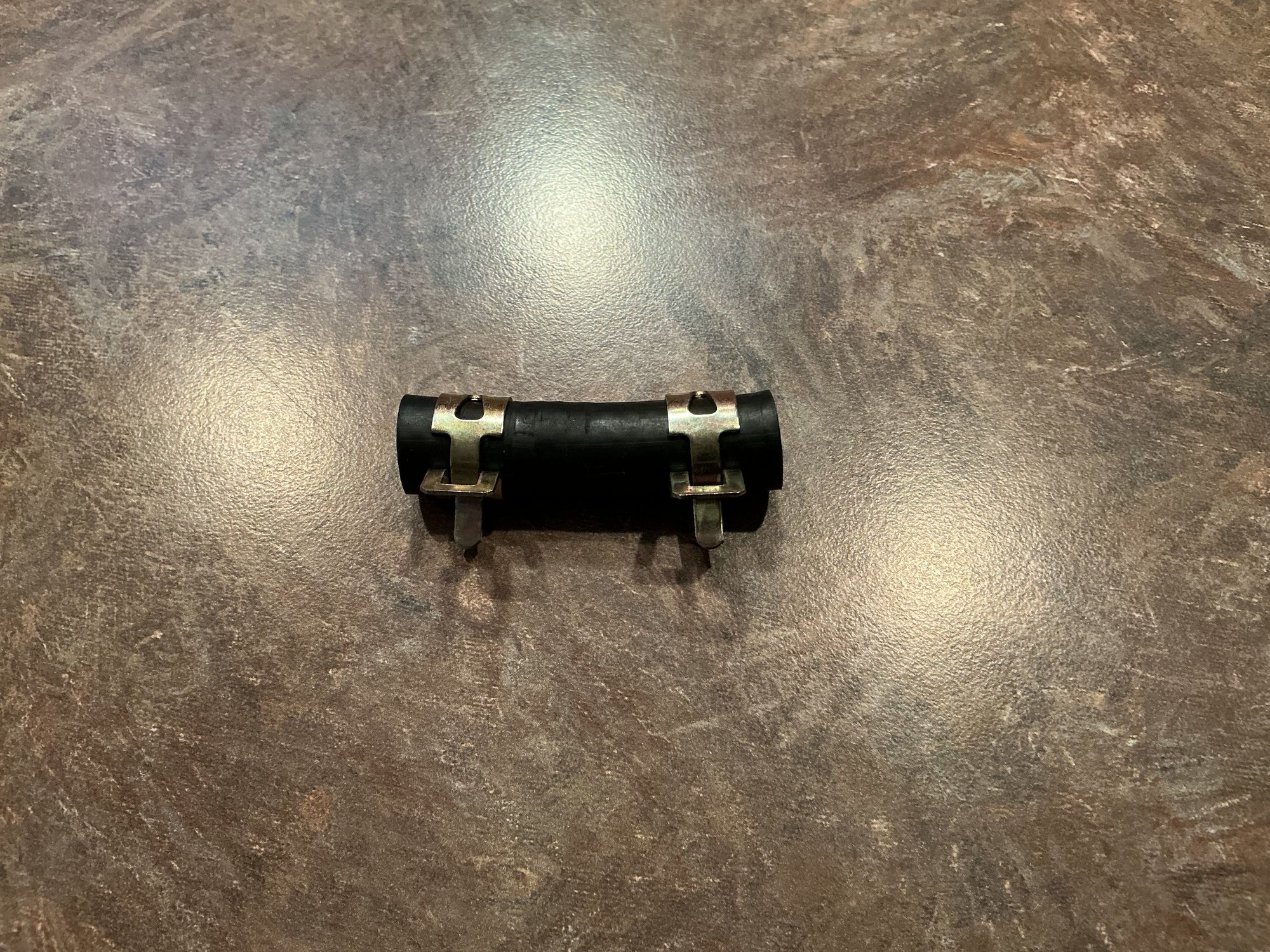

These connectors are fascinating; I mean the variety and the creativity of the mind that came up with these things. I've spent a lot of time trying to figure out how they work and I usually wind up breaking something and then the "trick" to how it works becomes apparent. ;^)
