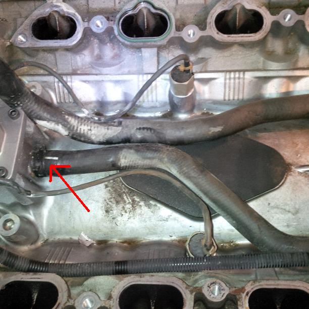

You won't be able to get one of the hoses off without removing the Manifold. You already did the hard part. it's a good time to clean the gunk from the top of the engine.

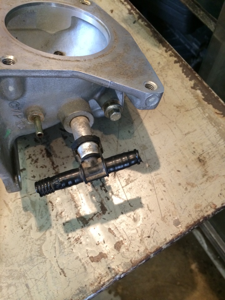

Do yourself a favor and go ahead and order a Part-Load Breather hose now...it runs from the left valve cover, underneath the intake manifold to the induction elbow, and then to the EVAP system I believe...you WILL break this old piece of plastic as you disconnect it from the induction elbow. Luckily it's not expensive...your part number is AJ84880. It's available in the US for about $25 USD.

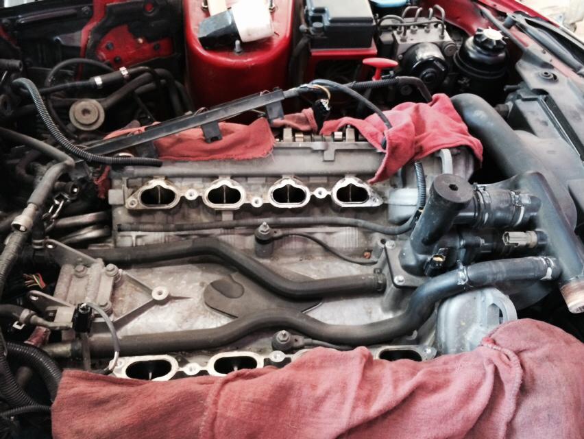

I'm with The Coupe. I just finished replacing the valley hoses and I replaced all of the other tubes and connectors given my XK8 is a 1999 what didnt break in the process will soon anyway. A good investment in the long run as opposed to being left stranded somewhere or having to go back in to deal with something later. Here are some pics of my work and I replaced the thermostat and housing while at it

11 years later and your comment saved me. I just removed my intake and all to replace my valley hoses, and the Part-Loader Breather hose is the ONE THING that was broken. Saved my life listing the part #, brother. Thank you! 2001 XJ8 Vanden Plas.

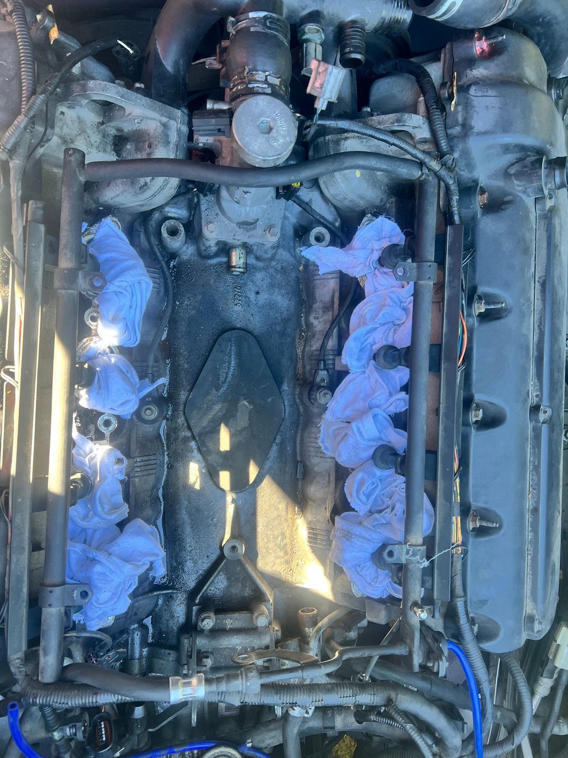

I had a leaking valley hose and replaced every rubber hose. Did by tilting manifold up and not removing.
Hints:
1. the octopus hose is held in by a zip tie you can’t see;
2. get hose clamp release pliers including one with extension cables;
3. heater hose to firewall will look partially kinked; 4. hose pliers a good idea;
5. cut old hoses lengthwise at connector to ease removal;
6. Silicone spray to slide on;
7. Bandaids for knuckles.
My thread at: https://www.jaguarforums.com/forum/x...r-hose-288201/
