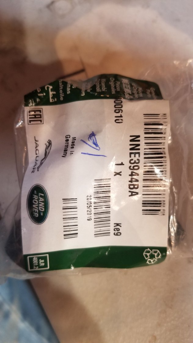

I haven't work on any newer than '01 but I assume the '06 is similar. I would purchase the part I show below. It conects the valley hose to the octopus hose and a hose that goes to the TB.
Yours may be OK, but if you tear it down and it is bad it will take you several days to get one. It only cost around $10. I keep a spare in my shop because it delayed me a week on one of my projects.

^^ Yep, replace that lousy plastic T-connector as part of the job. The one in my wife's 2006 XK8 started weeping slightly in early January this year. I found the T-connector on amazon for about $8 and purchased the proper O-ring for it at NAPA for about $1. The NAPA part number is G60248-0010. It is a Gates Hydraulic O-RIng....
I believe a new O-ring for that T-connector comes with a new octopus hose. I bet it does NOT come with new valley hoses.....
