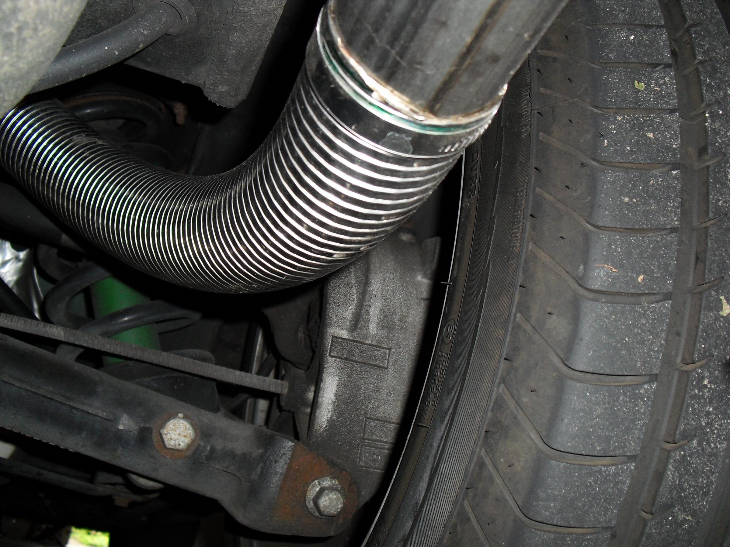

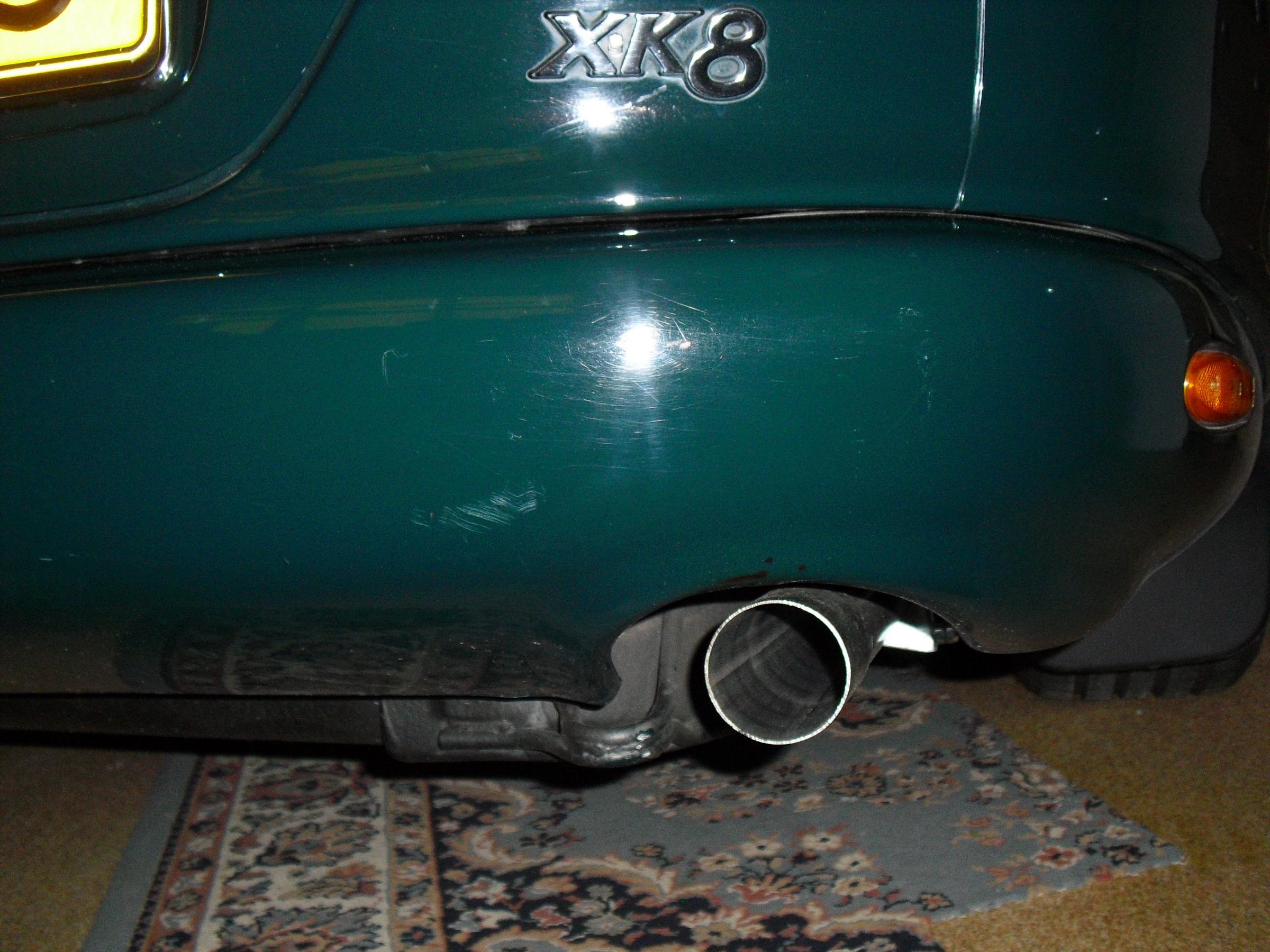

talking abt mounting rear exhausts; pretty basic stuff from diy did the job for me. 75 Euro's per side was the total cost for pipe, flex and mounting equipment....
