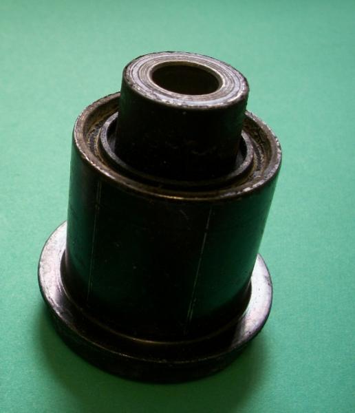

Here's a new Lower Wishbone Bush:
The one you've pictured doesn't look bad although it's very difficult to make a visual assessment and you really need the load off the suspension to check for play.

There's three wear points on the lower wishbones:
item 5 - front and rear bushes
item 6 - Stabiliser Link
item 7 - Lower Ball Joint
The assembly is beyond wiggling due to the weight but a small bottle jack beneath each of the arms in turn can be used to detect vertical movement in the bushes due to wear and a pry bar will reveal horizontal play. Rocking the road wheel will show any wear in the Lower Ball Joint.
If the bushes are worn, a press is required to remove the old ones and fit replacements. Exchange front and rear wishbones are available from several sources in the UK and, even with shipping, this may be a cost effective approach with the exorbitant labour rates in your part of the World.
