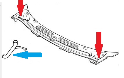

Check the drains at either end of the Plenum Cover (arrowed in red):
They drain through large diameter tubes (arrowed in blue) to clear rainwater rapidly from wiper action and the heater inlet.
When they get blocked, the water can either run off the surface or go into the Master Cylinder / ECM compartments.

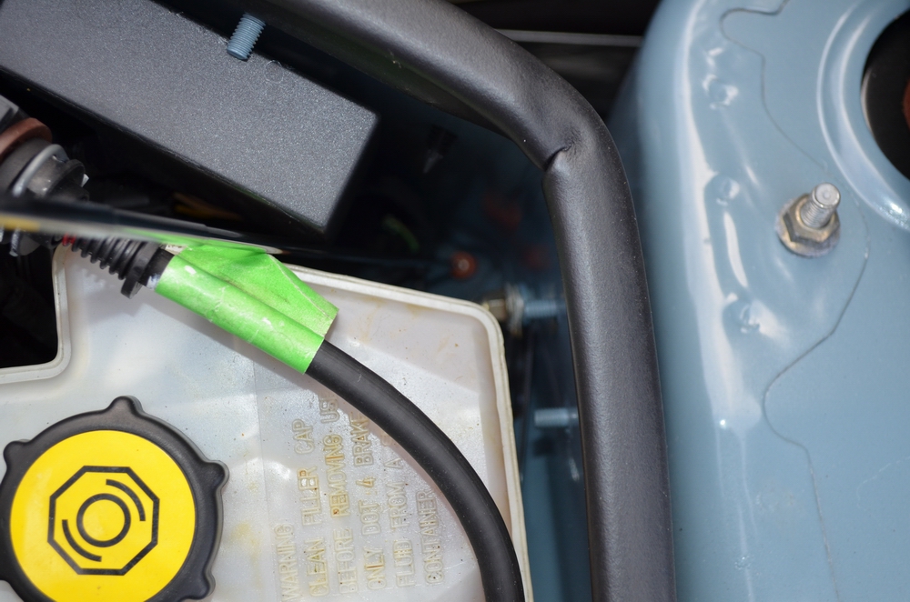

Water is 3-4" deep under the master cylinder, is there a drain there?
Old May 7, 2013 | 01:14 PM
Likes: 17,008
Ignoring the minor details that my Master Cylinder is on the opposite side to yours, there is a drainage slot at the inner front edge of the box section.
The chrome pointer coming into the pic from the left has an orange tip at the location of the drain slot.
This is a 2005 but I can't see why the earlier Model Years should be any different.
