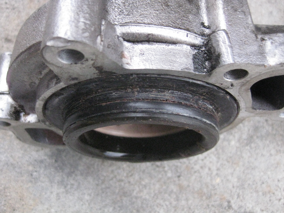

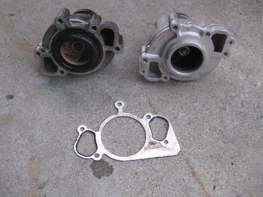

So as part of my pm this year I am doing the water pump on my 2001 XK8. .
The old uses a seal, like a crankcase seal with an o-ring to seal into the engine body and then the gasket for the side holes. The new just uses the gasket.
Any comments?

I bought a pump like that. The gasket was not a problem, but after a year I found that the o ring that seals the insert had been pinched on assembly and was leaking slightly. I just need to replace the o ring and get a new gasket.

I would go with an OEM pump. The lack of the oring will allow a vortex around the intake that may decrease pump efficiency. The lack of a machined gasket mating surface is also low quality and could weep. The new pump is a poor copy and does not belong in a good car..

went to the dealer and got the better pump and gasket for $10 more than incorrect one from local auto parts store
