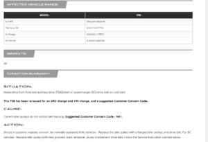

There was a bulletin for chirp noise on start up - the pulleys and idler bracket is supposed to be changed along with the belt, but its VIN specific, relating to all 4.2's.
It could be that when you changed the belt - which will not be stretched, is now causing more load on a bearing in the belt drive system?
I take it the noise is only present when engine is under full load?
+1 with Marc - maybe try changing the oil in the supercharger might help.
" Filled for Life " - Need to be careful with this statement. Treat it as " Filled for Life of Warranty ". This is merely a selling trick they use, but will only cost you more in the long run. Let's be honest, things wear out and break. If you keep the fluids changed, they will last longer. They say this about the transmissions, diffs, etc... You can still change the fluids in the transmissions and diffs if you choose to do so, wont hurt anything.
* Keep the fluids changed at regular intervals *
See attachment for bulletin info
