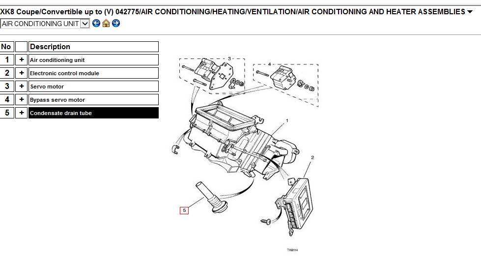

Old Jun 22, 2013 | 03:41 AM
Check the AC Condensate Drain Tubes (item 5) aren't blocked or detached.
Condensate should drain through two tubes either side of the transmission and exit beneath the vehicle. A detached or blocked drain allows condensate to pool on driver's and/or passenger's floor.

Will give it a shot. Are you saying there are 2 drain hoses. Tough to tell from the pick. I do know I get the typical condensate drip when the ac over by the pass side footwell area under the car but if there is one on the drivers side that ties into it then it is possible.
Old Jun 22, 2013 | 10:34 AM
YES - there's 2 of them.
That illustration is from the Parts Catalogue. I've checked JTIS but there's no better diagram available there.
