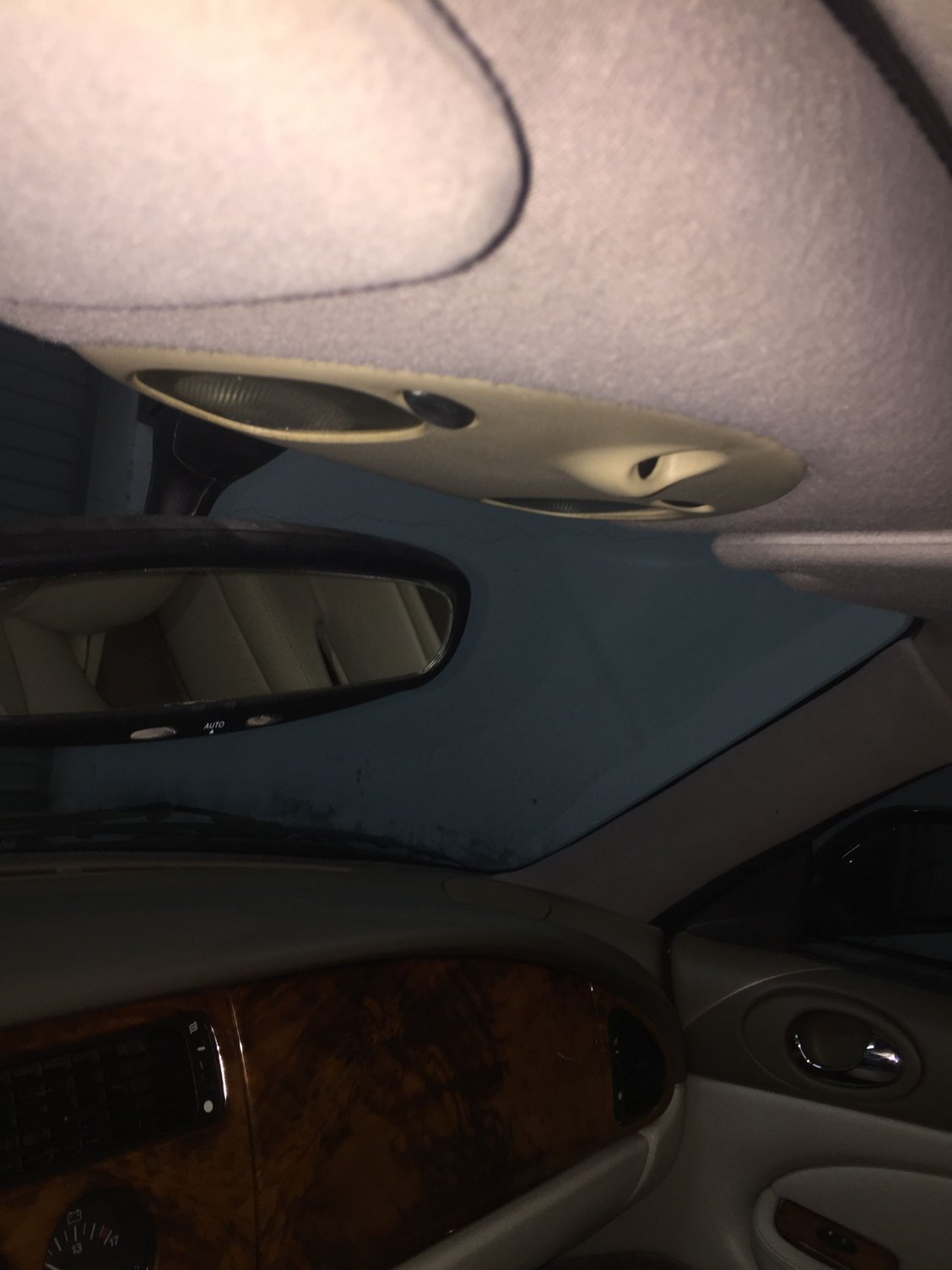

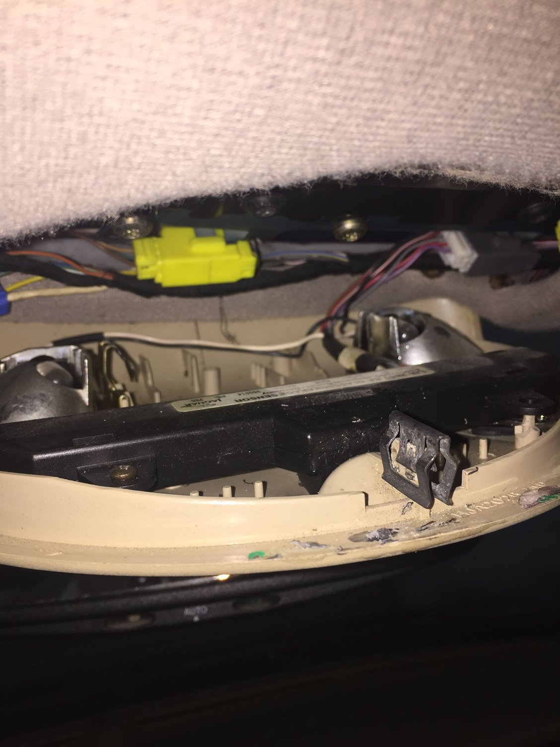

My 1999 XK8 had a semi-annual droopy overhead console courtesy of a half **** bodge job from the previous owner aka mastic, paper clips and Velcro! Yep! Wouldn’t believe it unless I saw it with my own eyes.
I had a recent overhead annoying squeak and the unit then drooped again so I decided to take a good look.
It’s suppose to be held up by 3 plastic tang clips, 2 rear, one in front. The front tang was missing the clip and the rear mounting bracket on the car was missing entirely. 2 brass screws with broken plastic around it.
So the previous owner had put a mastic “plug” on the rear of the unit onto the rear view mirror to hold up the back of the unit. Yikes!
I rooted around my box of spare bits and found a clip for the front plastic tang. Simple temporary fix.
Looks secure for now and no squeaks. Result!
Now I need to find the mount for a full repair.

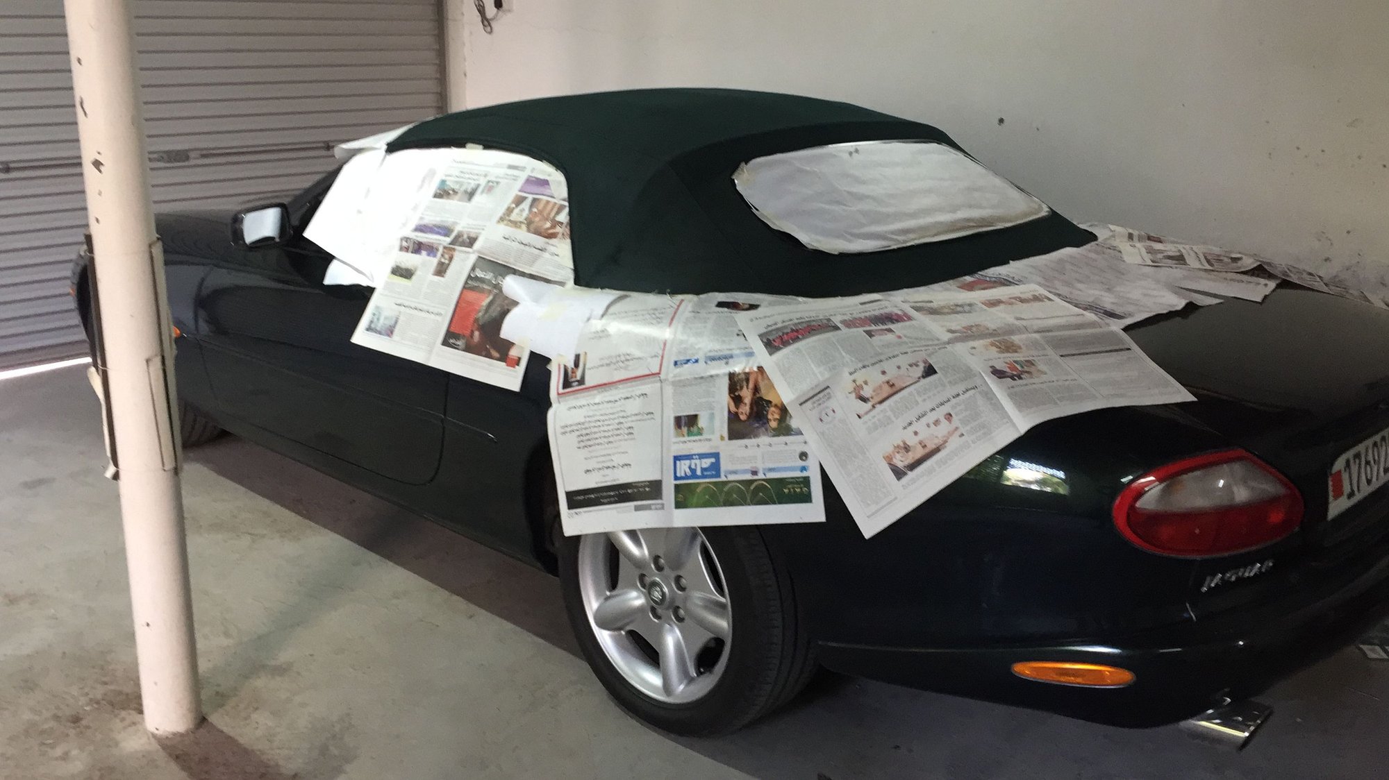

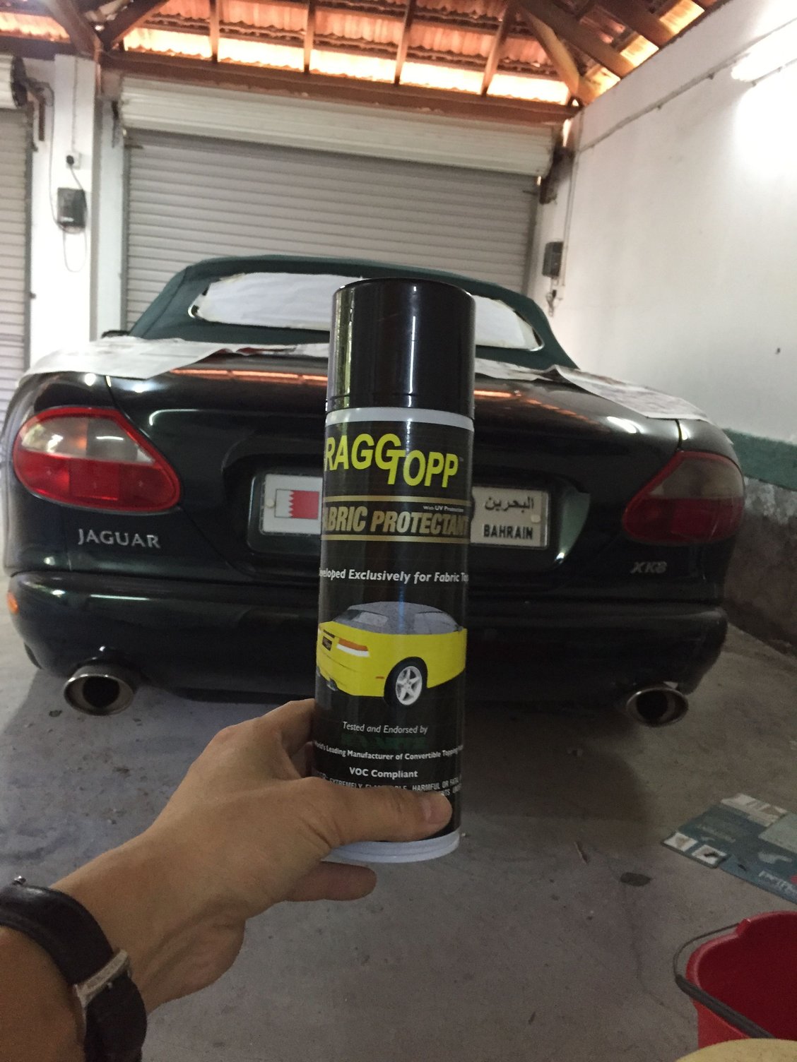

With the wet weather season coming in the Middle East, I knuckled down to spray the convertible top with Ragg Topp sealant. First was a vacuum hoover, gentle shampoo wash, let it dry then hoover again.
Easy job, but needed to mask the car up first to prevent overspray.
All done in approx 2 hours. You have to wait for 15 min between Ragg Topp coats. I went for 3 coats. Can said it needs 24 hours to bond.
At least Ragg Topp said there’s UV protection as I’ll see more sun then rain in Bahrain.

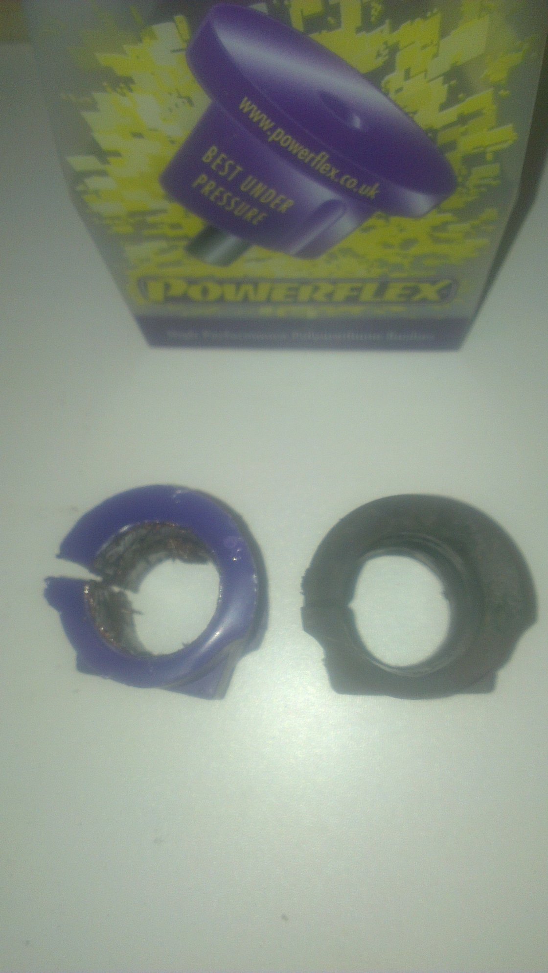

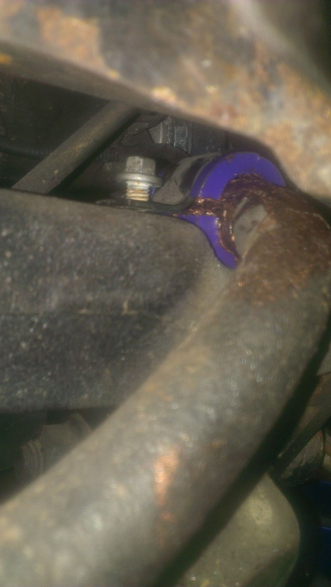

Finely got round to changing my front anti roll bar bushes and drop links.
(should read Finally..and not as if i have a mechanic called Finely) ha ha.
I changed the bushes to Powerflex poly and used Meyle drop links.
The old bushes when removed and examined had crack's around the out side edge's
Also the bottom part of the bushes had worn very thin.
It was a right pain to change the bushes but well worth the effort.......
