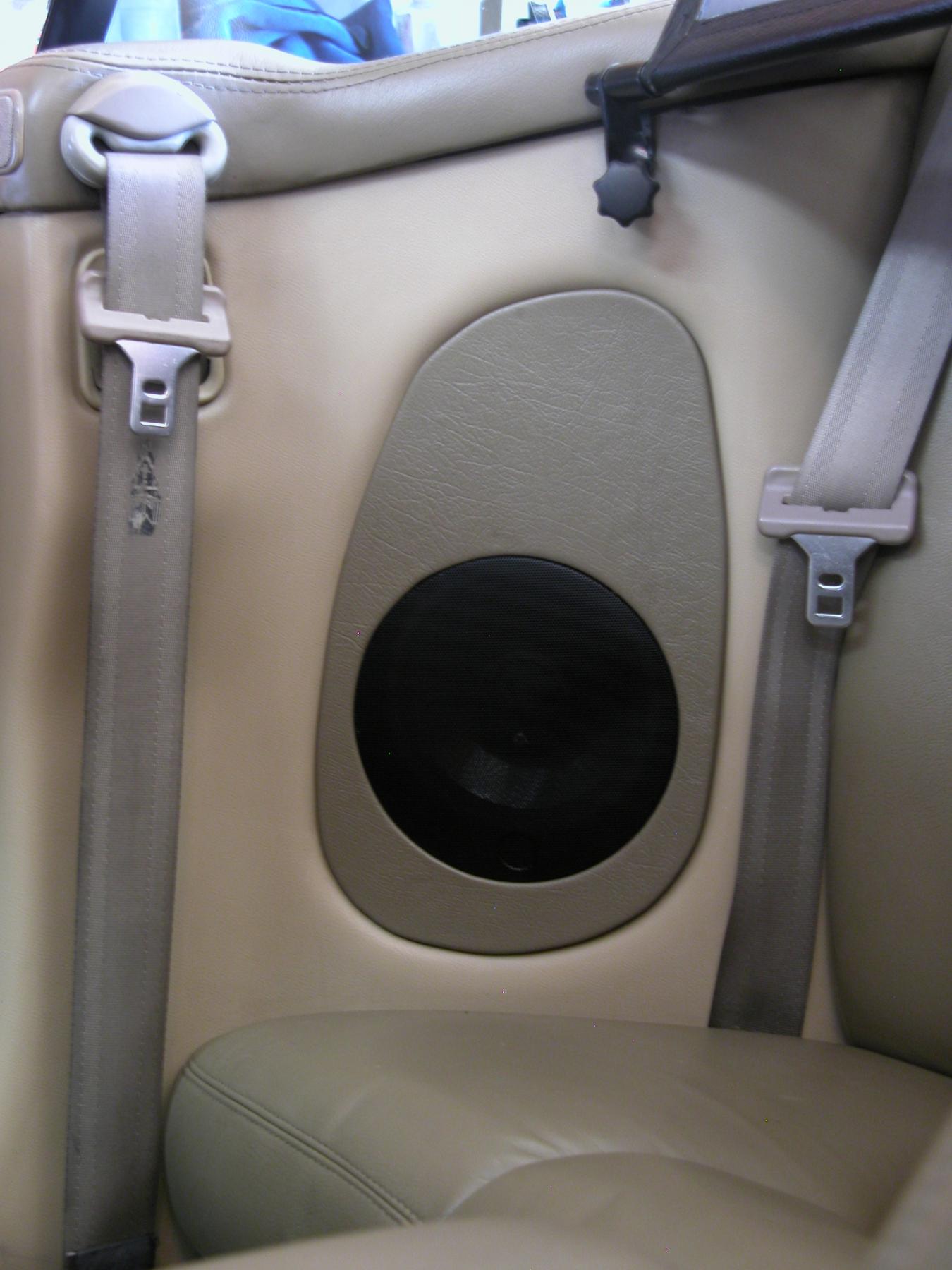

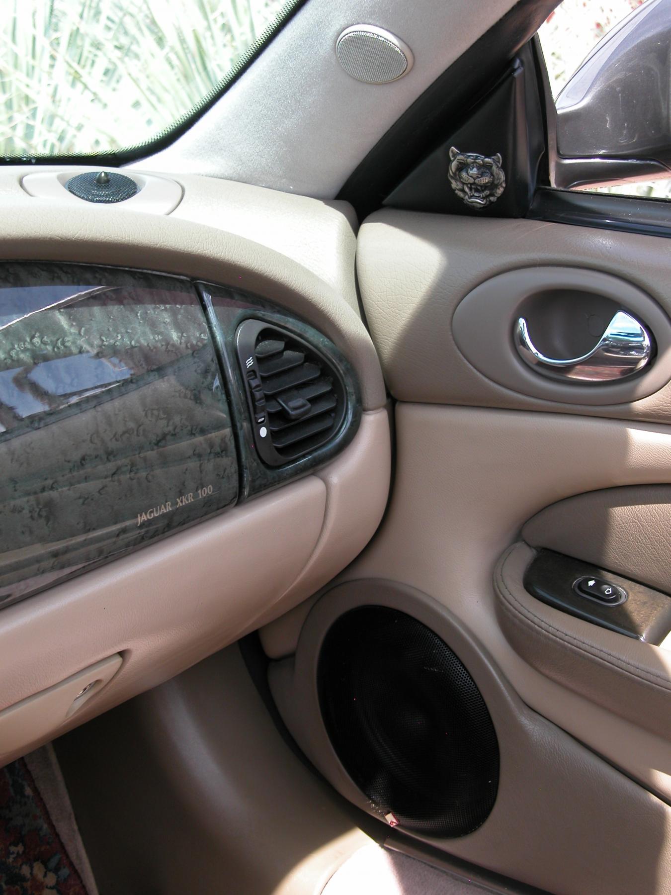

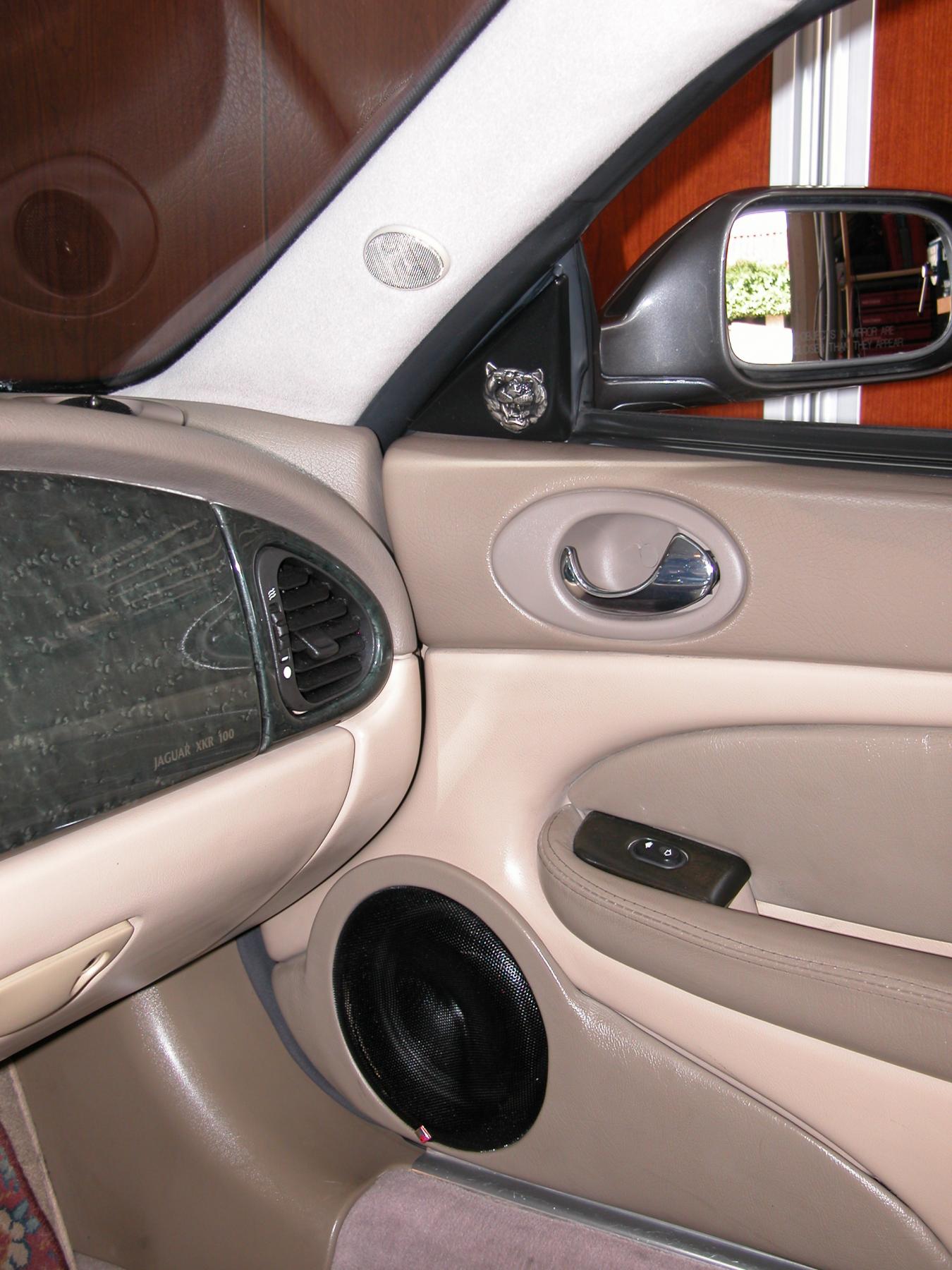

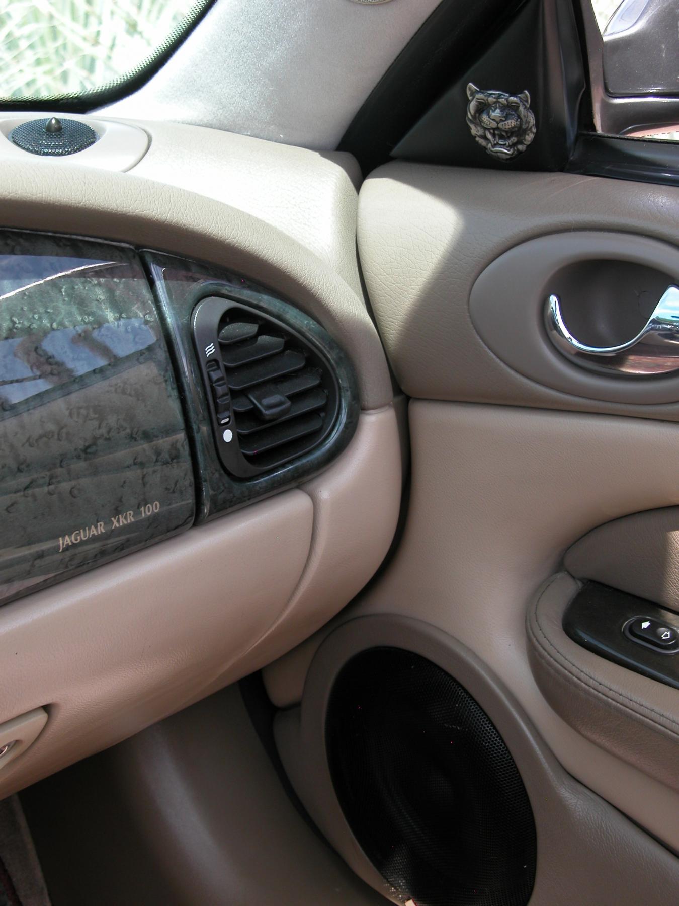

Hello All, I actually started this project about a month ago and finished up in the last few days.
I did a custom install on the speakers in the front door, front dash and rear seat and removed the tweeters in the corner windows.
I used Rockford/Fosgate T4 component speakers.(pretty high end)
I had already added a subwoofer in the front passenger footwell.
After the speakers I added a 3sixty.3 Fosgate digital sound processer.
The sound system sounds amazing, the digital processor tuning makes for some incredible improvements to the sound quality and of course the speakers can handle power and all the highs, lows and midrange.
The complete sound spectrum is literally tuneable to your exact specs/liking.
The pictures that follow will show your the actual custom install.
