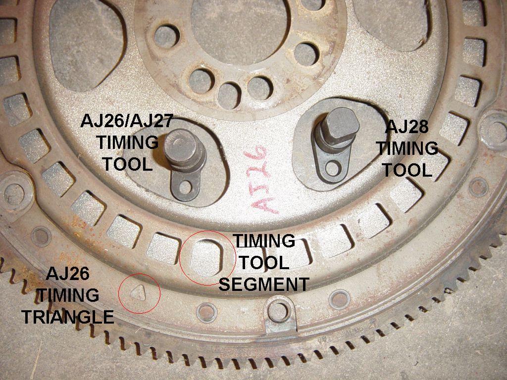

what do these parts do
Old Aug 28, 2020 | 07:34 PM
stevepaa's Avatar
Joined: Mar 2010
Posts: 904
Likes: 185
From: san jose
Default what do these parts do
the two short plugs, one silver and one gold
Old Aug 28, 2020 | 08:36 PM
v8deuce's Avatar
Posts: 129
Likes: 34
From: Kelowna BC,canada
I have a tool kit similar to take for setting the cams (timing belt) on my s40 volvo
Old Aug 28, 2020 | 09:11 PM
stevepaa's Avatar
Joined: Mar 2010
Posts: 904
Likes: 185
From: san jose
i have the complete kit but do not remember how i used the plugs when i changed the chains.
Old Aug 28, 2020 | 09:16 PM
motorcarman's Avatar
Posts: 13,759
Likes: 9,713
From: Wise County,TX
The AJ26 and AJ27 use a 'crankshaft lock tool' that is different from the AJ28 'crankshaft lock tool'.
They are both included in your timing set.
Old Aug 28, 2020 | 09:42 PM
stevepaa's Avatar
Joined: Mar 2010
Posts: 904
Likes: 185
From: san jose
which one is for my 2001 aj27
thanks
Old Aug 29, 2020 | 08:18 AM
Posts: 13,759
Likes: 9,713
The one that fits the timing slot.
Old Aug 29, 2020 | 11:01 AM
stevepaa's Avatar
Joined: Mar 2010
Posts: 904
Likes: 185
From: san jose
priceless thanks

and here is is installed.

As per TSB 303-10.........
Caution: Do not use JD 216, crankshaft setting peg, to hold the crankshaft
when tightening or loosening the center bolt of the crankshaft.

yes, i read that
i did this

Remember to only rotate the crankshaft in a clock direction when viewing the engine from the front of the vehicle. Rotating the crankshaft anti-clock results in damage to the main and rod bearings.

to do what i did, it was rotated about 10 degrees CCW to set against the frame.
